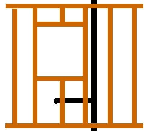

I find it very interesting that you can't run a proper vent because there is a window behind the sink... That must be why nobody ever puts a window behind a kitchen sink... Oh wait a minute... Almost every kitchen sink I see has a window behind it! I wonder if they alll have AAV's... As I have often said where there is a will there is a way... See the diagram below...
As I have often said AAV's are for lazy plumbers! People that take the easy way out and end up having some Tin House on Wheels plumbing! They actually like the farting noise the AAV makes as it lets air in to protect the trap seal and they also like the poop smell they give off when they fail!
