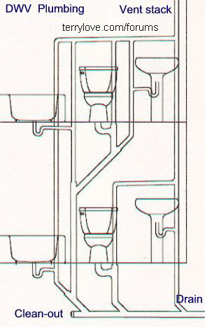

I’m building an extension at the back of my house, where I want to add a toilet. There is no sewage pipe there, however there’s a 4 inch PVC vent stack, going from the building drain directly to the roof, with nothing else connected to it. Is it possible to plug into the vent and use it for toilet sewage?

Normally once a vent, always a vent. Dropping waste from a story above can siphon traps in floors below. And there is no telling how the fittings were put together below the concrete. I would hesitate to plan for a working bathroom there when it may not work afterwards.
The best bet is to connect where the lower floor waste lines are, and not to use a dry vent for waste above.

You guys were right, I checked my roof and this is a water drain. Curiously there is an airvent nearby that is also ran outside and looks identical. However, it’s a lot harder to access, so instead I will opt for a saniflo toilet and pump the waste to second floor, then connect it to the same drain as the toilet bowl.
