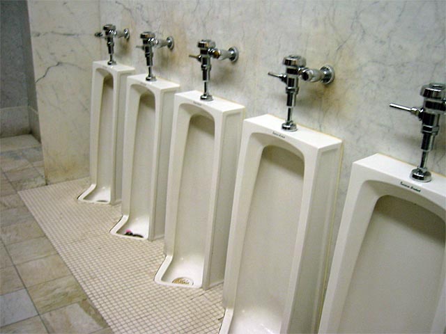

I have 3 boys (so far); 4 year old twins and a 2 year old. Our current home seems to have a permanent puddle somewhere, rusted radiators etc. They've got a good 20 years before they figure out they need to sit or kneel...so has anyone installed a urinal in a home? We will be building a new home soon and this seems like a profitable idea for the day-use laundry/bath area.
The height range using this will be a two year old up to myself and everything in between. What models are easier to hit?...those twins aways need to go at the same time. Something on the wall or all the way to the floor? How easy is cleaning? Is sweating always a problem like commercial versions? How much can we plan on spending?
We're tired of apologizing to the guests..."sorry, we havn't cleaned the toilets since four o'clock."

I installed a urinal in a house last year. the plumbing aspect wasnt any more complex than other fixtures.Cost depends on the model which is up to you.They make rustproof baseboard if you are going that route.I sell it to all my customers where heat is near a toilet.

As a plumber I installed a urinal in the master bath a few years ago, works fine.
BasementUrinal
I would recommend though a type of urinal that covers the entire wall like the picture above so it serves the purpose of height changes throughout their growth.
The wall hung type would either have to have a step stool placed in front of it to make up for height reasons. My grade school did just that.
The cost for a urinal is under $200. More and more customers of mine are moving to this idea because of the issues you mentioned.
I did work for a customer last year replacing a mansfield with a toto drake comfort height and I think the two boys missed more than they hit that old toilet I pulled out.
Made sure I embarrassed the customer by mentioning this factoid because I certainly didn't buy the excuse it was just cleaned a few days ago. Freaking gross and I charged accordingly.

Porcher use to manufacturer a residential urinal that looked like an access panel about 12 inches square, it was hinged at the bottom. You could pull it open and use it then close it back. I saw it advertised in a trade magazine probably 15 years ago. I went searching for one a few years ago and never did find it.

rugged: too institutional, although the function is unquestionable.
terry: that looks nice, but the price tag is too high to justify.
I think I'll take a look at a local supply house and see if anything jumps out in the less than $200 range. We're hoping for something with a little bit softer appearance, although it will be in a pure utilititarian laundry room/bath.
Is there any special plumbing requirements? I'll have plenty of pressure available a 1/2" supply line. Manual controls are preferred. What about the sweating issue?
1,193
Why would a urinal sweat more than a toilet? My guess is that it would be less, not more since there isn't a resovoir of cold water stored in a tank after each flush to cool things off.
