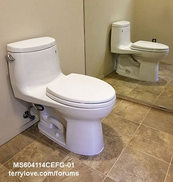

I have a MS604114CEFG Toto Ultramax II 1.28 gpf toilet (from 2015) and I always felt like the small amount of water in the bowl itself allowed more odor to escape during use, compared to less water-efficient toilets I had before. Not horrible, but kind of unpleasant.
Meanwhile I also have a cheap 1.28 Kohler (also 2015) that's a worse toilet in every other way, but it holds slightly more water in the bowl so it doesn't have this specific issue for me.
So, the question: for people who prefer to have more water in the bowl when using, is there a Toto toilet that just keeps more water in the bowl than the Ultramax II 1.28? Thanks!
MS604114CEFG
MaP Score 800 grams

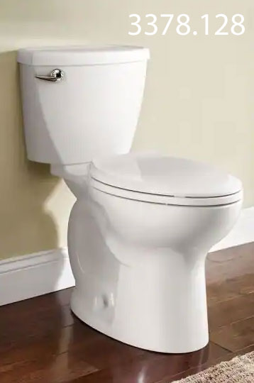

Cadet Flowise 3378.128
MaP score, 1,000

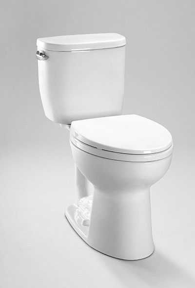

with The Am. Std. Cadet 3 FloWise elongated 1.28 and want to recommend it. Has EverClean surface (we'll see if it amounts to anything), is chair height, flushes like a champ and decent water spot of about 9" x 7-3/4". Nice price under $200 and much nicer than Toto's CST244EF Entrada that is a good flushing WC without the special surface treatment.
CST244EF
MaP Score, 1,000 grams
The ballcock inside the Cadet is Fluidmaster decent, and most Toto's have either the worthless toy-like green junk or Hunter style that I could take or leave. Fluidmaster beats Hunter in my book.
I've literally never run into the complaint you speak of about odor escaping.
The FlowWise has a MaP performance score of 1,000. (grams). https://www.map-testing.com/map-search/
