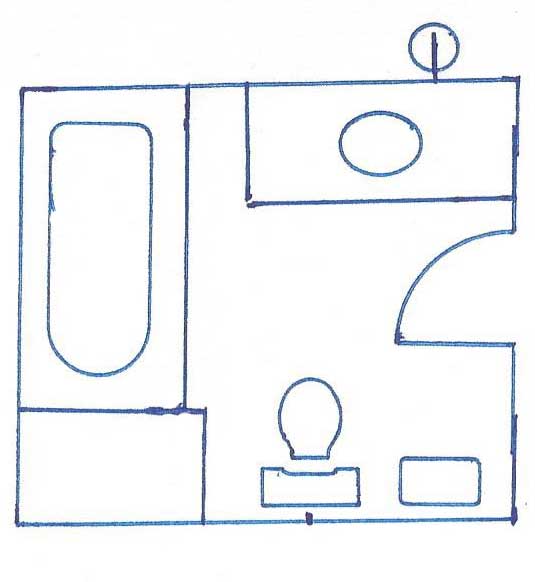

Hello. My situation is that I'm remodeling a 100-year old bathroom (78" x 90") were all the current plumbing/venting is on the right-hand side. I'd like to move the toilet to the left-hand side, which will actually put fixture spacing more in code and allow for a larger vanity sink. I'm in Minnesota a the code is UPC. Here is the problem:
The closet flange trap distance to connect to the main stack will be about 7'12" give or take. I know the UPC says 6' max, and IPC say unlimited for trap arm to vent. I was going to use 4" pipe instead of 3" since that is the current connection to the stack anyway. I'd prefer it if I could just run this and not add a 2" vent pipe, but I'm happy to be told this is a horrible idea.
I would just run the 2" vent pipe per UPC code if it were that simple in this old house, but the left wall tops out in a dormer of a finished attic. The joists were 2x6 and doubled to make code at the time by the contractor. It's close enough to the knee wall that I'd only have to go through one set of joists. But I can't just drill a 2.5" hole in 2x6 and meet code there either since it's more than a third of the joist and closer than 2" from the top or the bottom. If I do this I could block on either side of the cut joist to the joist on either side to reinforce, but this is a lot of work. Last, if I do vent and cut the joist this would put me near the main metal stack. I could get there with a couple of 90˚ turns.
The shower and sink will tie into existing venting that I assume must tie into the main stack as there isn't other vents coming out of the roof, but haven't demoed that yet to confirm.

How about a picture showing what we are looking at with some dimensions? Can be uploaded as an attachment 800 pixels or less.
A 2" vent through the roof will handle the entire bathroom.

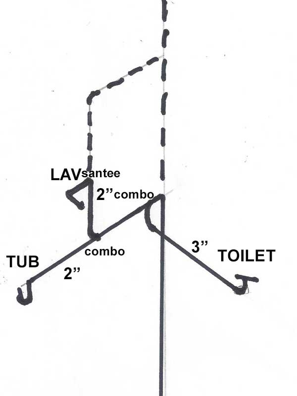

I would consider cutting the cast below the fitting for the bathroom and using a santee, head over toward the wall with the window with 3" and picking up the toilet with a combo and then run 2"over to the lav and tub.
The 2" only needs to go as far as the 2" combo for the lav and then the tub can use 1.5".
The wet portion of the lav is 2" and the vent can reduce to 1.5" and then tie back into the main stack.

Wow. Thanks for drawing that up to clarify. The layout is what I was shooting for and I will make some built-in storage by the back of the tub/wall. I was thinking to do a 30" lav so as to have about 28" for a towel bar between lav and shower. I'd prefer a 36 but have no idea where to hang towels then.
FYI: I do not believe that the old tub or shower vent anywhere other than into the wall. I'll know when I demo that part of the wall to tile, but I ran a wiring fishing tool along the side they would have connected to the stack and did feel a santee connection for them. There is nowhere else they could vent to.
So then 3 subjects for questions in this situation you so kindly drew up. I'll try to have these be my last. Thanks for helping and I really appreciate you Terry.
1) The main thing I wonder is part of my original inquiry which is that the dwv from the toilet flange to now the lowered wet vent 3" combo long turn wye is still a bit longer than 6'. I'm measuring around 66" horizontal plus around 16" drop. Are you saying just not to worry about it not being code since it will be fine? Or are you saying your layout is code for UPC?
2) The stack center is about 15.5" from the tile. Isn't that where the dwv for the lav should go? So then should I cut more out to add a santee for the lav directly into the stack? I don't think the stack is supported at all so I assume I should add a stack clamp in the knee wall in the attic, right? Basically given that I'd like to cut it higher as it also sticks out of the wall at a female connection, doesn't it make sense to cut it from below the fitting all the way to the knee wall where I have access and replace it all?
3) Lastly, if I do need to vent it on the left wall behind the toilet to be code and I use a long turn wye horizontally, instead of putting the cleanout in the back, could I extend it sloped up steam and use a santee to get the vent more in line with the wall and put the cleanout there instead? I guess technically that dead-end 3" section would be close to vertical but as you see the existing stack fitting top is only 1.5" below the joist. After pitch this doesn't leave me enough hight to run the 2" at 45˚ to the wall cavity.
