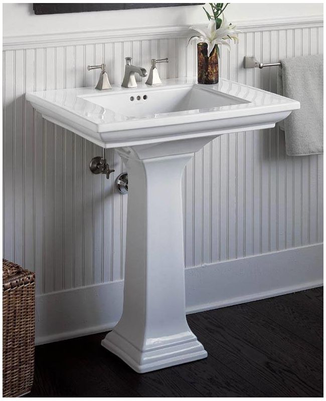

Kohler Memoir sink:
You may also have a problem matching the white colour. Kohler Memoir toilets are all ADA/Comfort Height.
Even the rounded lines of the Transitional Drake tank lid may clash with the sharp lines of the Memoir vanity.
