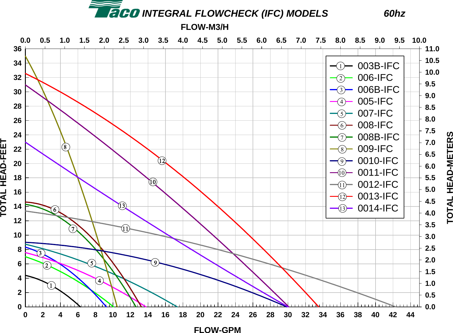

The -0011 isn't a particularly high head pump (the -007 pumps more water at 13' of head than the -oo11) , it's a high volume pump. The -008 is indeed a high head pump:
With some radiant systems with gazillion loops plumbed in parallel a high flow pump might be called for, but there's almost no point to putting high-head pump on the potable side. It might need to be higher-head to deliver enough heat if it's on a high pumping head water tube heat exchanger tankless water heater, but an -008 would probably over-pump the water heater to the point that it's lifespan is shortened considerably.

The pumping head of the Vertex is extremely low and the pumping head of the (as yet unspecified) heat exchanger isn't much. The Taco 008 is totally not the right pump for the application.
