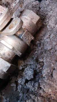

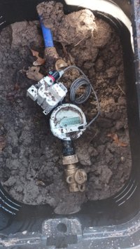

Thanks again for your help.. i am outside of Dallas, Texas. I dont think butt welding is easy for a beginner like me ? what is the next best option for interconnections ? I was thinking of getting 3x 500 ft rolls and have junction boxes every 500 feet. since i was going 24 inch , i was thinking of digging sides ways and putting some cinder blocks, so i can access it in the future if there are problem with couplers or if we need to branch out, or a shut off valve there to isolate leaks ? thoughts ? Below are pictures of the water meter connection.. since it almost level to the ground. what is the best way to get from here to the 24 inch deep. I was thinking of having a valve box about 3 meters away, so i i can have a hose bib close to the meter ? so is it ok to bring it straight 3 meters straight into a valve box, and then have a hose bib there, and then go with a 90 further down to 24 inches, and then run the 500 ft line ? or start slowly sloping down to 24 inches from the water meter. Any suggestion on the right connectors to use ? i am sure others have done it.

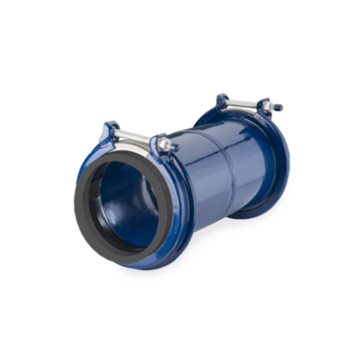

I would use the gripper type compression coupling with teeth that won't let the pipe slip out past the o-ring. Running the compression couplings through a valve box is a good idea, as keeping them from being covered with dirt will not let roots grow under the o-rings. I would not use sharke bites or ball valves every 500' as they are just more opportunities for a failure. Testing every 500' length for a leak is not necessary. If it leaks it will be at a coupling in a valve box you can see. I would also just use the plastic valve boxes with extensions as needed.
niko7099
13
texas
Thanks a lot ... the compression coupling that I found dont seem to have teeth. finding stuff has been challenging.. do you know where i can buy them online ? Also what is the best way to tee off at every 500 ft if i want to have a spigot there ?
ford "grip joint " ," Pack joint" or" quick joint" which type you like or another brand mueler? just wondering respect your opinion realize you may not tried them all but probebly have one youve been happy with . Id say its a good idea to be picky on long runs and deep lines etc.

The first ones I used looked like these. https://powerflexfence.com/products...0-hrSfC79k0qAFU8VRtsVFTiiR-S-sU4aApSFEALw_wcB
But they quit making that brand and I used some that looked like these. https://www.pvcfittingsonline.com/2...b6k5I_ic-N839BgSlH73-qqDCZ2cxx_0aAlEaEALw_wcB
Neither one of those ever pulled apart, but the roots grew under the o-rings. I think they would be fine if you kept them in a valve box and didn't let them get covered with dirt.
I also had a few tees with hydrants along the way, and just used a PVC tee, ball valve, and short nipples, with a compression coupling on both ends to connect back to poly. Roots under the o-rings in the compression couplings has been my problem. I am going back with HDPE tees and fittings, even the ball valve, and am butt fusion welding instead of compression couplings. Just replacing them as they start leaking from the root problem. Only have a couple more to dig up. Where I still have threads or a compression coupling underground, I wrap in plastic and salt the dirt around the pipe to keep roots from growing in there.
Jeff H Young
8,962
2,236
92346
I been using what looks very similar to the philmac coupler you outlined on underground gas without issue but these are newly installed time will tell ....
