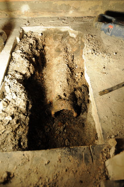

I think this is okay to do, but asking just in case.....
Recently had plumbers remove a CI pipe from under a load-bearing support (no footing) in basement.....I could never have done what they did, and I'm still having difficulty sleeping thinking about it.....I am thinking of filling in the removed material with concrete. I figure I should wrap the PVC that replaced the CI with sill seal to give it room to expand, and also allow replacement later if necessary. Is there anything wrong with this?
The support sits on a plate, but there is evidence of structural failure in the past so I am not complacent.....

Is this the one in question?

Yes. That plate (top of picture) is now sitting on air.
I freely admit, I could never be a plumber. I don't have the nerves for it.

Put dirt back in the hole.
Wet it until a puddle forms.
Use a broom handle to poke into the dirt allowing the water to all disappear.
Add more water creating a puddle.
Repeat the probing.
Do this repeatedly until the puddle isn't going down.
Wait 24 hours.
The pipe should be covered with dirt.
Pour concrete.
Done!

Sand better than dirt?
This is the procedure I was planning for the whole trench (and the dug-up laundry room).
But I have to wait for inspection first....
Would concrete under that plate be a waste of time, or downright harmful?
According to my engineer, he doesn't know what's holding up that plate. I haven't told him about recent developments.

Use whatever material is required by your local code.
Use the compaction procedure I gave above.
I would put a sheet of plastic between the wood and the concrete.
You can tell your engineer not a helluva lot!:eek:

That plate is being supported by both sides of the concrete slab. There is little, if any, pressure on it because of the way the wall is constructed. Just pour your floor slab and forget about it.
