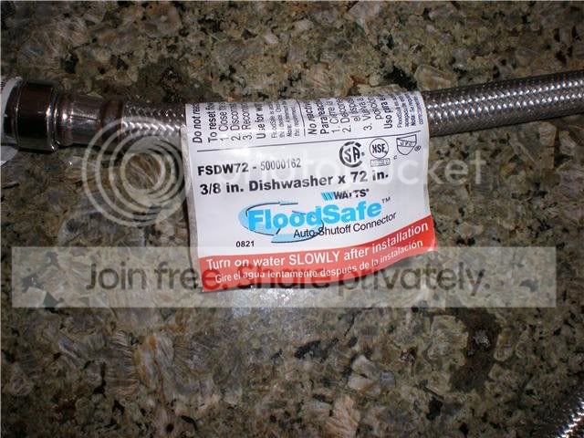

    Today, I installed a new Frigidaire dishwasher in my kitchen and now there is almost no hot water pressure in my sink after running the dishwasher for the first time.
    The sink and the dishwasher share the hot water valve. The rest of the house's hot water pressure is working normally. Before the install there were no problems with the hot water pressure in the kitchen sink.
    I ran the dishwasher on a complete 'normal' cycle without any dishes inside; I then lost hot water pressure in my sink 20-30 mins into the cycle.
    The dishwasher install went over smoothly--no leaks, no unusual operating noises, or odors. The dishwasher that was replaced had not been used in years and is a older GE model from 1981.
    Currently, the dishwasher has been off for several hours and there is still no hot water pressure in the kitchen sink.

    I am thinking it is the line, too. It has some line slack that coils the pipe, but there are no kinks or sharp bends.
    I bought a dishwasher supple line kit, something similiar to this:
    [​IMG]
    I wrapped both fittings on the elbow with a small amount of Teflon tape, as well as the fitting for the hot water faucet that leads into the supply line.
    Should I remove the Teflon tape around the end of the elbow that already came attached to the supply line?

    Those connectors don't need Teflon Tape,
    Yes remove it.
    If if it has a label that says "Floodsafe" throw it away.
    Have you removed the supply line to the hot side of the sink faucet?
    You can check there to see if the stop is clogged.

    I think I found the problem.
    The supply line is an "anti-flood/auto-shutoff" feature line. I think this may explain the low pressure in the sink.
    I am heading out to the plumbing store to pick up regular steel braided flex pipe without the 'auto-shutoff'.

    you do not need to replace it. Disconnect the hose from the valve, put it back and turn the valve SLOWLY open.

    Yes, and then when he runs the dishwasher and it gets into the rinse cycle, it can shut itself off again.
    Then he removes the fitting, resets the floodsafe, and finishes the wash.
    And then the next day he can do the same thing.
    Pretty cool.
    You can almost run load of dishes.
    I wonder how many dishwashers are burning out?
    Being run dry.

    quote; you do not need to replace it. Disconnect the hose from the valve, put it back and turn the valve SLOWLY open.
    At least not now, but he will have to when it disintegrates and floods the kitchen. Replace it NOW before that happens.

    These floodsafe connectors are AWFUL! I installed a dishwasher with one and it wouldn't pump water in and I noticed it was a floodsafe connector and thought it might be that. Had to take everything apart, install a new line, and now it works wonderfully. They need to re-think these things, maybe have them be rated for higher flow or something.

    I like most Watts brand products but every time I see a "Floodsafe" supply line on a job, I replace it. I will never leave a job with a "Floodsafe" supply line. They are so bad the major city I work in and around will not approve any plumbing with "Floodsafe" supply lines.
