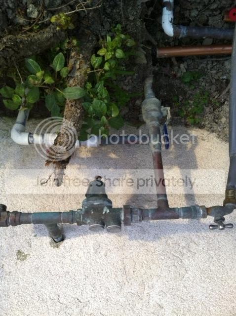

Hello gentlemen, im back after being in hiding for a few weeks. Well as I had initially thought 5-6 hours labor, lmao yeah right, with my 2 year old trying to help me anytime I went outside to work on this project, a 9month old little girl, some rain and oh ya and ....WORK, has now turned into weeks. These past few days ive dedicated maybe 2 hours total to the project, and the hardware store runs are really beginning to kill all my time, no such thing as a quick hardware run in the big city.
I've tested my water using the hach 5b kit, its at 15 gpg.
At any rate I want to thank everyone who has chimed in on this thread.
Now for the subject at hand, I am a bit confused after talking with a gentlemen at the "hardware" store about my install. He mentioned water heater and that I should've plumbed into the plumbing at this source, this confused the heck out of me as I thought I had it all figured out. I have posted a photo of what im working with and what my plans were.
Not sure if this would even be an option but in case anyone is wondering my water heater is located directly to the rear of my house, about 40'-50' away from the softener.

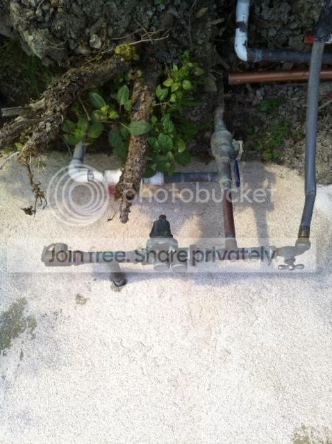

Below is the main i will tapping into for the installation. On lower left is the pipe coming off of the main, then lower right pvc is for sprinkler system.

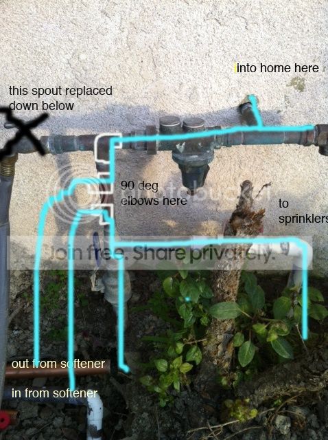

This is the photo with my plumbing diagramed, elbows along the vertical main with in/out to softener. The water spout will be replaced down on the horizontal pipe with a t-coupling so it is plumbed before the soft water.
Excuse my photo shop crooked lines.
Thanks again to all of you for your help, I hope to wrap this up

I wouldn't install it that way. The softener would be before the pressure regulator valve. That is a bad idea.
And I don't know if it matters but suspect it does, the PRV is installed upside down and I've never seen one installed that way. It allows sediment to have built up in it and that may prevent it from working correctly.

I wouldn't install the softener per your drawing either.
I'd install the softener on the right side of the plumbing after installing a new PRV valve or taking the present one apart to clean it, and getting it right side up, and then remove the pressure relief valve (PRV) and go on to my softener inlet but....
I would cut the vertical line above the main shut off valve and the irrigation TEE so as to lower the hose bib/PRV horizontal line about 2" (without interfering with the access to the irrigation line valve handle) so I could unsolder the TEE on the house line now and then install an elbow on the line into the house to connect my outlet line from the softener.
If I were going to bury anything, I would be very careful digging so I could find any underground lines without damaging them. If the irrigation is off to the right of the pics, the line probably goes along the house wall instead out away from the wall.
IOWs I would extend the present hose bib/regulator line to the right to the softener, leaving the existing hose bib valve/regular valve and irrigation lines as is. The regulator valve is on a union and the relief valve is threaded. I'd unsolder the TEE going into the house after getting the water out of the line by disconnecting that union.
I'd cut out about 2" of the vertical line from the main shut off valve and use a repair coupler to put it back together as is but with the regulator right side up and no relief valve (unless it's code) and then I'd put it on a tee and with it directing any water flow out away from the foundation of the house.
To solder the coupler you must get the water out of the line below it at least an inch but as far as possible is best. And to do that you shove a rag down inside the line using a screw driver etc. and soak the water up into it until the water is down as far as you can get it.
Fleck has the inlet come in on the right side as you face the valve. I would install a shut off valve in the inlet line. Outlet is on the left side as you face the valve. New inlet line comes in under the outlet and up into the inlet, outlet goes over the inlet line onto the line into the house.
People don't steal PVC, so instead of using copper, I would use 3/4" PVC pipe from the threaded end where the relief valve is now and to the copper going into the house. And I'd add a #4 bare copper ground wire from the copper coming up out of the ground to the copper going into the house. You could take that down into the dirt and along the house up to the copper below the main shut of valve so very little is visible... That is to maintain any main house electric panel ground using the present copper water line.
If you want a soft water hose bib, add it on a TEE in the softener's outlet line.

Below i've sketched a rough draft of the new plumbing as suggested. Any new ideas or suggestions? The wife will take the kids for the day to allow me a day to get this done the right way, or at least try to. ;)

Marcello, you drew what I described, the only (hand operated shut off ) valve I mentioned is on the outlet of the softener, dittohead had added like a dozen valves here'n there. I see no reason for more than my one on the outlet and even then, it isn't needed, just nice to have IF your by pass valve can't shut off water to the house while you troubleshoot a problem with the softener. And that's only needed IF the people inside the house can't follow directions to NOT USE WATER until they are told it's OK.... Fleck by pass valves don't do that as far as I know.
The only thing with your drawing is, I suggested installing the softener to the right of the existing plumbing and you drew it to the left and down while out from the wall. That's not a problem though, you can run the plumbing anywhere you need it to go. If you don't bury the softener, your inlet will go over to the left or right and then UP a couple feet, and then the outlet down and over to the left or right to the house copper.
if you've already bought the copper, then use it but any extra valves should be able to be returned with a receipt for a refund or store credit. Thinking about it, copper tubing and all fittings should be returnable as long as you didn't cut the tubing yet. PVC is much easier to work with and much less expensive. Plus it has a larger ID than the same size copper. And you could lightly sand it and paint it whatever color ya wanted to.
BTW, since dittohead's "professionals" here haven't asked yet, where are you planning to run the drain line? And what type material are you going to use?
I suggest a foot or two of 5/8" OD, 1/2" ID opaque PE tubing from the control valve to 3/4" PVC if you're going underground. It's nice to be able to see water flow or air bubbles in the drain line IF you have a problem with the softener.
I see you don't take the copper ground wire to the copper below the copper main line above or below the main brass shut off ball valve. That is where it has to/absolutely must go, not to a ground pin.
