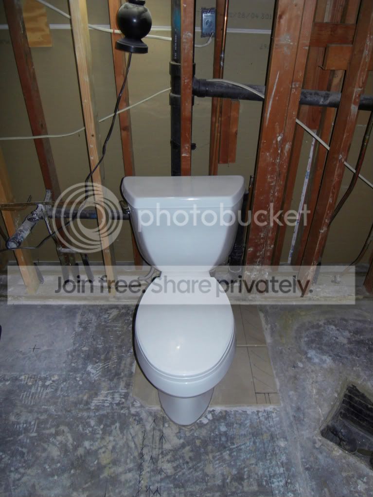

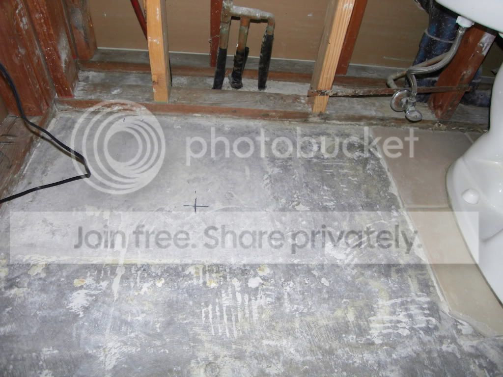

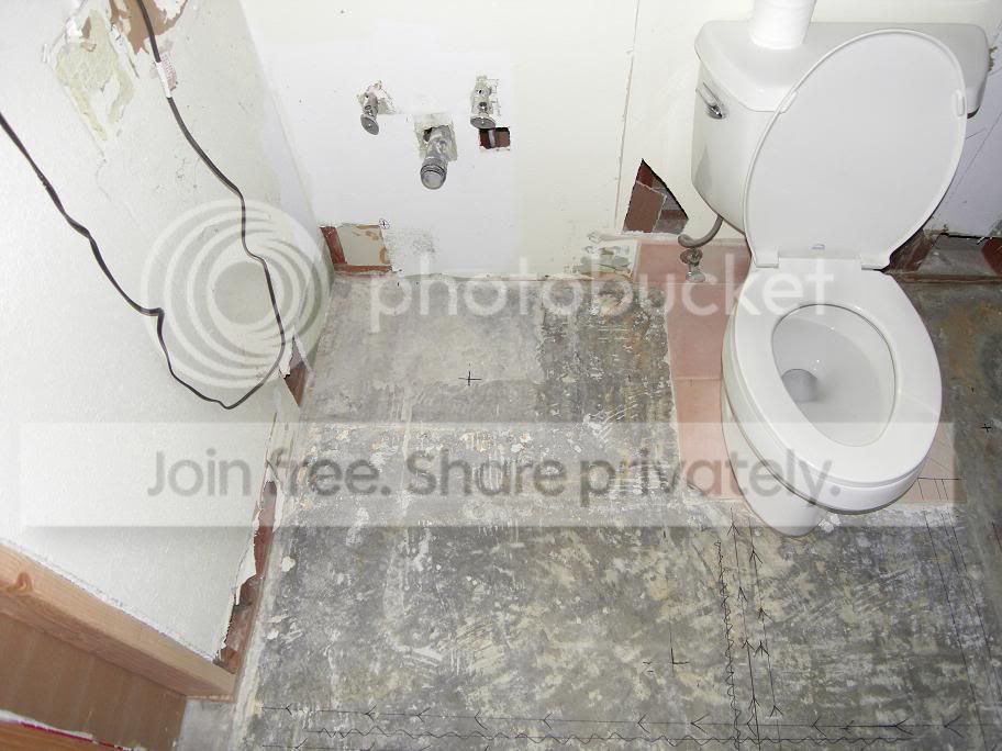

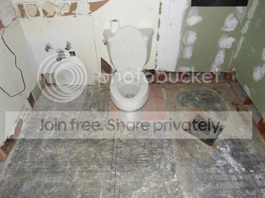

    Okay, here are a couple of pictures to show you where I am at and how far I need to move the toilet. As you can see, I've located all of the cables and am ready to start plumbing!
    [​IMG]
    If you look to the left of the toilet, there is a cross where I need to relocate the toilet ... better seen in this photograph. So, some pipe between the new location to the old, using a couple of street elbows, would suffice?
    [​IMG]
  6. hj
    Joined:
    Aug 31, 2004
    Occupation:
    Location:
    toilet
    WE cannot tell you what fittings you need because you have to see the existing connection first.
  7. piperca

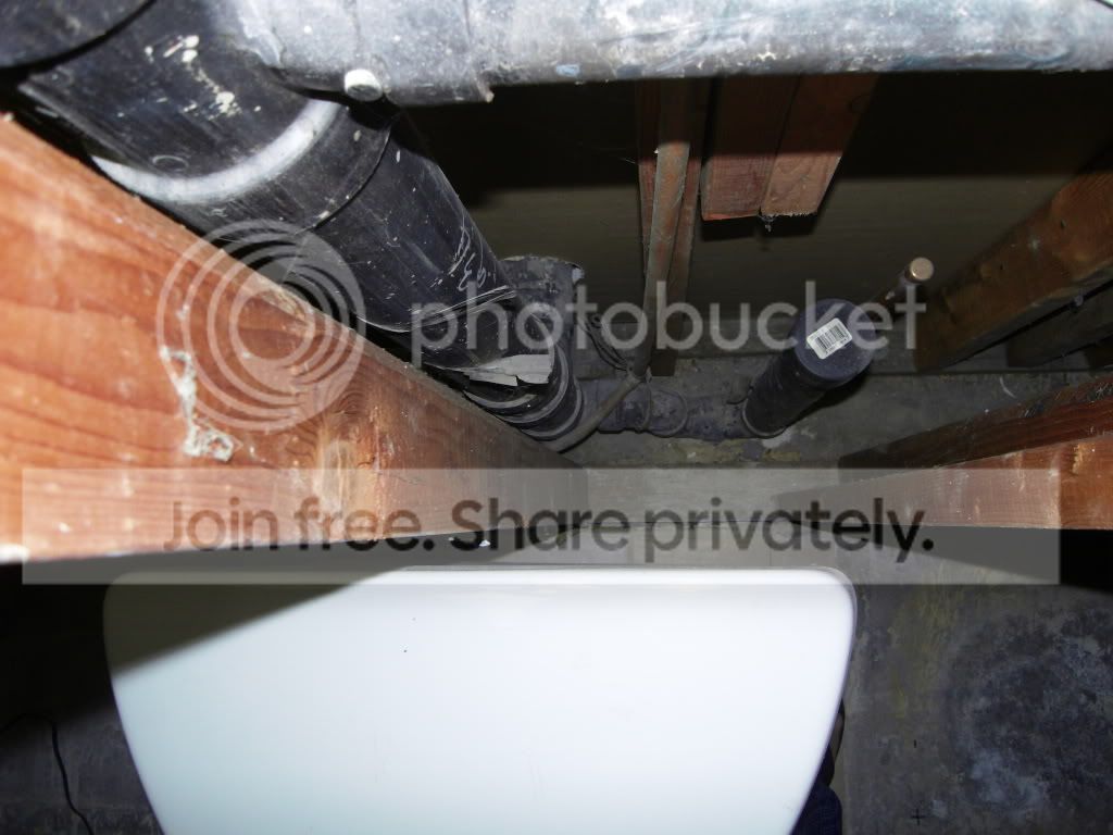

    Okay, here are a couple of more pics with the drywall off.
    From the center of the closet flange to the center of the pipe behind the toilet with the cleanout is 18". The waste runs directly between those two locations. The center of the closet flange to the center of the new location is 28". Does this help or do you need more information?
    [​IMG]
    [​IMG]
  8. hj
    Joined:
    Aug 31, 2004
    Occupation:
    Location:
    toilet
    We would still only be guessing. You will probably be able to move it using a 60 degree bend or a 90, depending on what you find, but since the installer could have been creative, until you actually see the pipes under the floor you will not know how you can revise it.

    Jim, the drain runs directly back to the 3" vent that you see in the photograph, behind the toilet (I've had this toilet off many times). Center to center, 18" of run. I can't get to the actual sewer line, itself, since it is in the plumbing chase and I'd have to disturb the framing to do so ... don't really want to do that. I'm thinking that I'll be able to cut the pipe a few inches from the 3" vent and install an elbow to get it to the new location. Here are a couple of more photographs that show the layout a bit better.

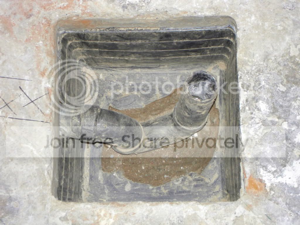

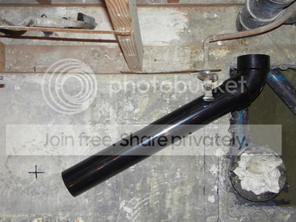

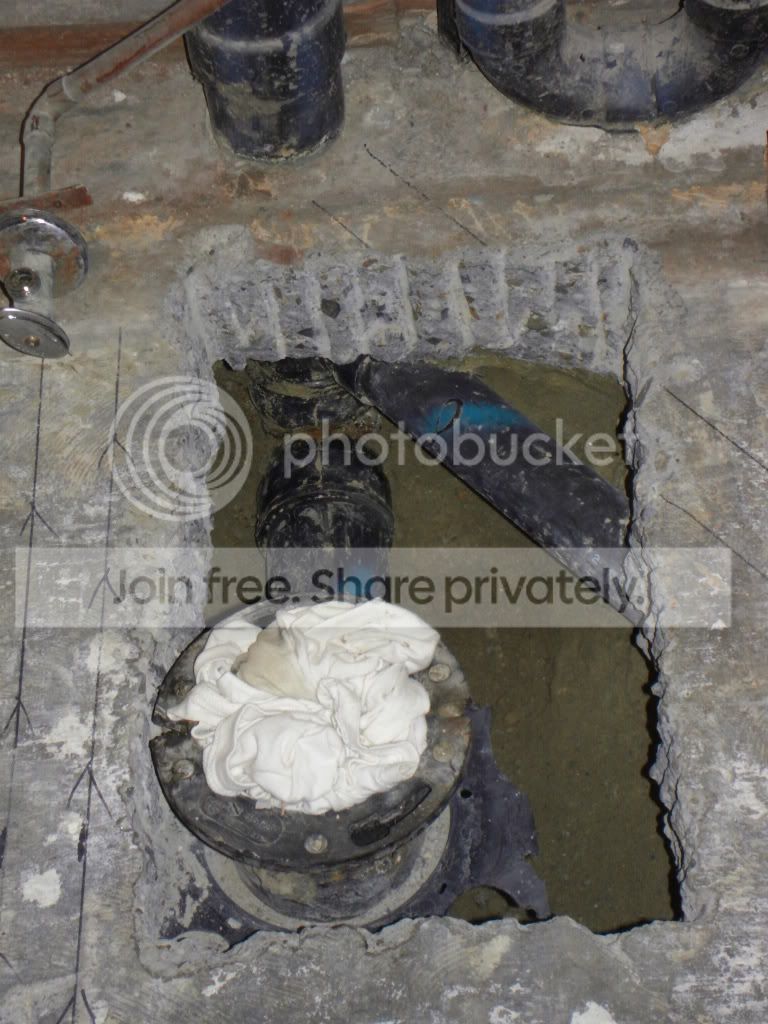

    Okay, finally back to my project.

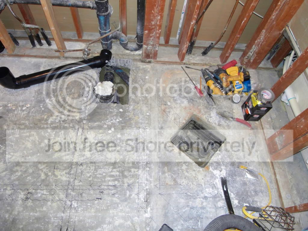

    I opened the floor today and found what I expected:
    [​IMG]
    My problem is this:
    [​IMG]

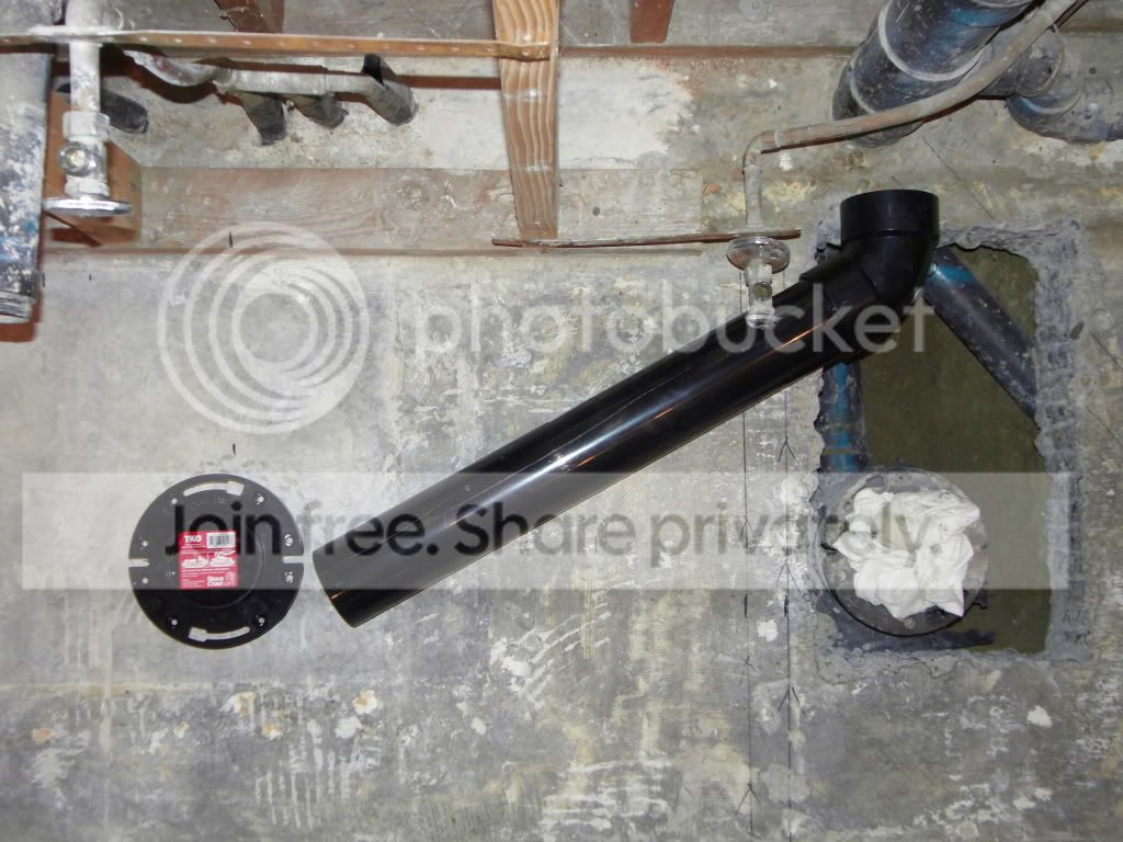

    Here is the flange where it needs to be:
    [​IMG]
    This is using a 60 degree fitting; would using a 45 degree and a 22 degree fitting help get me where I need to be ... another 7 degrees? What would be the best way to set this up? Any suggestions would be greatly appreciated.
    Also, the original drain uses a "closet stabilizer." The top of the 3" is about 10 inches below the surface of the slab, so I'll need to add something to the closet elbow. I've never seen one of these stabilizers before; are they necessary for concrete applications?
  15. hj
    Joined:
    Aug 31, 2004
    Occupation:
    Location:
    toilet
    I have never seen a "stabilizer" before so I guess that means you do not need one. You do not say any more about you sink drain, and that could be much more complicated than your toilet relocation.

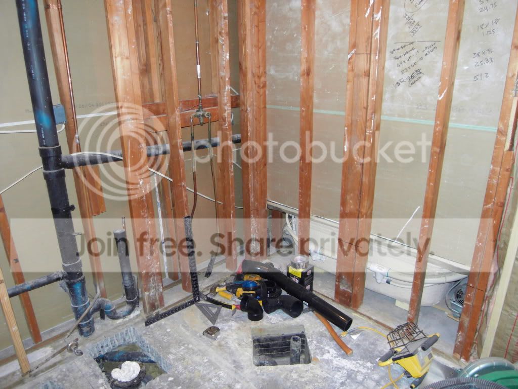

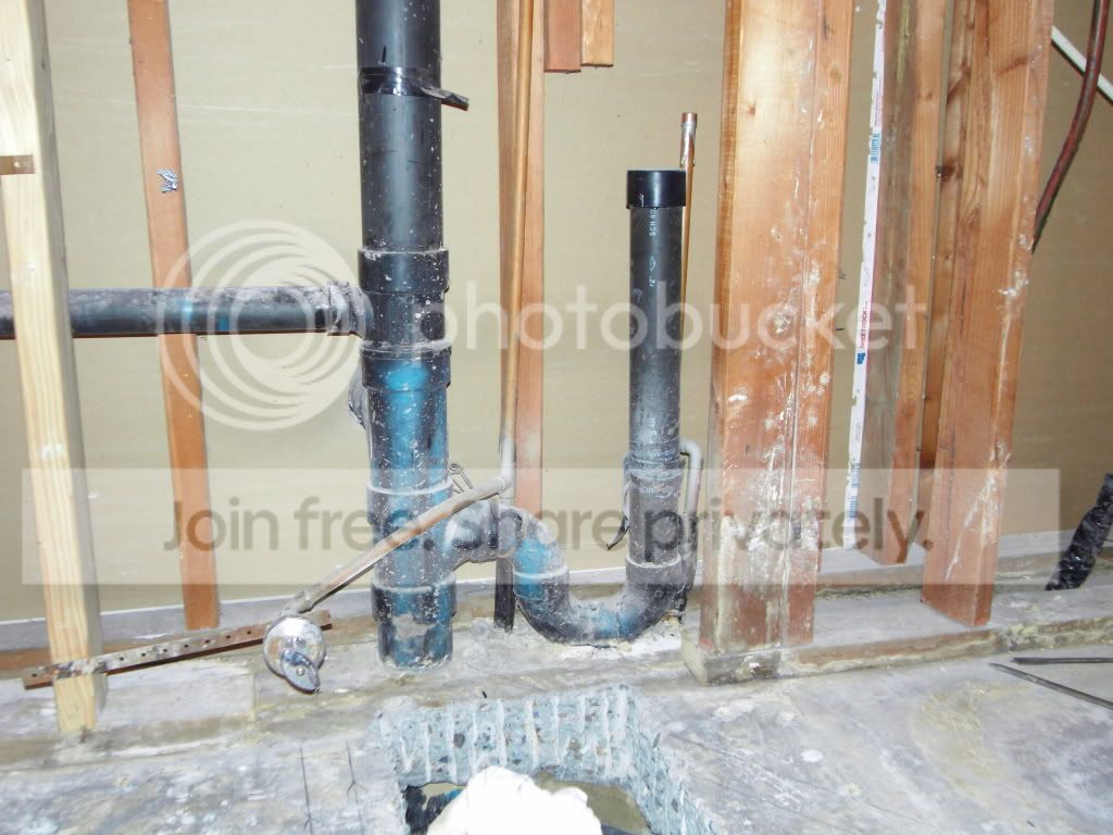

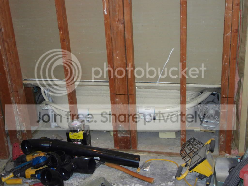

    The sink drain, I am not too worried about. Here is what I have (excuse the mess of tools):
    [​IMG]
    [​IMG]
    I intend on raising the floor or the shower the width of a 2x4 and running the drain from behind the shower drain trap to a chase I will build against the wall. Fortunately, my wife wants a ledge in the shower, rather than a step, so it will fit the bill perfectly for the plumbing chase.
    Here's a close up of the shower drain:
    [​IMG]
    I am going to put a T behind the trap and run the sink drain from there ... what do you think; will it work?
    I can also run the drain from this extinct washing machine drain, since the washer and dryer are now in the garage:
    [​IMG]
    If going this route, would I need to cut out the trap?
    So, back to the toilet, what is your suggestion? Am I looking for problems putting the drain in at this angle and adding fittings? Please comment on the best way to achieve the best result. Oh, and what should I use to extend the closet bend to reach floor level? Just a piece of pipe or is there an extender?
  17. Terry
    Joined:
    Aug 17, 2004
    Occupation:
    Location:
    You can install pipe and fittings in many ways.
    You are allowed 135 degrees of horizontal change on the trap arm.
    That would be up to one 90 and one 45.
    You could make that with 2- 45's or one 90
    It doesn't look like you will be hitting your location with the single 45
    And of course you can use varying lengths of pipe between fittings.
    Sometimes in concrete, I will use a 4x3 90 and stub a 4" pipe for the water closet (toilet)
    Then when the floor is finished, I will cut the pipe flush with the floor and use the closet flange like the one you have, but glue it inside the pipe.
    I then use a rotohammer with a 1/4" bit to drill to secure the flange to the concrete.
    I don't know what you are doing with the other fittings, but you can always cut some of what you have out, and raise or lower the tees as needed.
    The washer standpipe looks low to me.
    So........where is the new lav going?
    I think I missed that.
    What you had was a pretty standard layout, the most common layout you can have.

  19. hj
    Joined:
    Aug 31, 2004
    Occupation:
    Location:
    dwv
    You can use a long sweep 90 to turn the drain sideways, and a 4x3 elbow for the toilet with a piece of 4" pipe for the riser. Use an outside the pipe flange. Using the shower drain for the sink, as you intended would be a very bad idea, and you would still need a vent for the sink drain. You cannot leave the washer trap in the line and still use it for the sink drain. In addition, it is so low that you would have to "jump up" for the trap connection and that will also require a vent. One question. You said the sink will be on the opposite side of the room. How to intend to get from there to the washer drain with the shower between the two points?

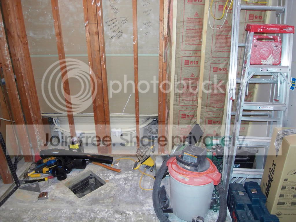

    I was hoping I could run the drain through the plumbing chase I was going to create behind the shower.
    This picture shows the wall the shower and vanity will be on. The shower will be on the left and the vanity (approximately 40") will be on the right, where the new framing is:
    [​IMG]
    I placed a black line on the studs, approximately 18 inches from the floor, showing the top of the chase:
    [​IMG]
    If necessary, I was hoping to cut a vent into the existing plumbing vent, which you can see running horizontally in this picture:
    [​IMG]
    How close to the sink must the vent be? Can I loop up, through the attic and back down to connect to the vent pipe?
    Here is a better picture of the washer drain. What must I do to it to make it work for the sink? Should I just cut it out and plumb in another fitting?
    [​IMG]
    The horizontal pipe to the left of the 3" vent is the drain for the old sink.
    Thanks for all your help!

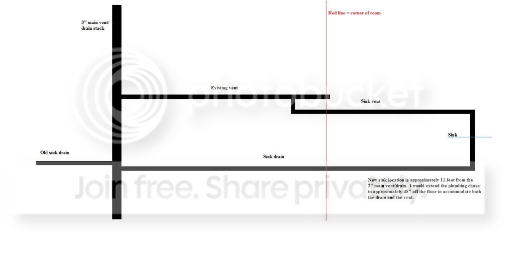

  21. piperca
    piperca Member
    Joined:
    Jul 4, 2009
    Location:
    Would something like this work? I could be wrong, but, in my opinion, the drain and vent line could run one on top of the other and be effective, as long as the vent is on top ... correct? Although, I'm sure there is a code that needs met.
