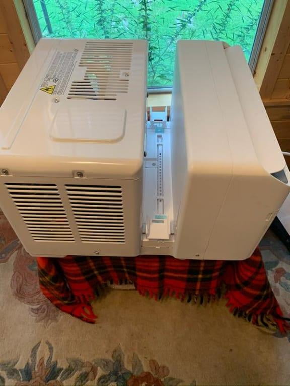

For cooling-only if you have double hung or single hung windows you might be better off spending CDN$400-500/each on a couple of U-shaped Midea window units. The sash slides into the U-slot between the compressor & condenser side, isolating the indoors from the compressor and condenser fan noise. These things are essentially a "cooling-only mini-split in a can" in many respects, and are as quiet as many mini-splits. The smallest in the series is rated 8000 BTU/hr, but the 1-ton versions also have a very large turn-down ratio, and throttle back to about 100 watts when both blowers and the compressor are running at their lowest modulation levels. I have no idea how efficient they are at minimum-output (it's probably not all that great at min-mod) but under CEER test conditions they score 15.0, among the highest efficiency window units sold in the US. There has been price gouging on the 8000 BTU/hr versions- I ended up with the 1-tonner simply because it cost less than the street/internet price on the 8000BTU/hr version, and was more available at the point that I was buying. (Looking quickly online right now I see that the 1-tonner is now priced 50% higher than it was at June Jeff Bezos' online store, but at the Walton family's box store the 8000BTU version pricing has started to fall back to earth at ~USD$442- still $100 more than it was in April. Menards has them listed at USD$369 each, with a $28 rebate knocking some off of that.) Given the upfront price difference between these library-quiet better class window shakers and the CDN$7.5K estimate you are expecting (also a price gouge under normal market conditions) the difference in cost would never be made up in lower power use over the service life of the equipment.
They're a bit of a PITA to install and a bit awkward to handle compared with other small window-shakers, but from a quiet comfort point of view it's as good as it gets short of a true mini-split.

thanks for the replies guys.. i was hoping Dana would reply :). I am going to go over this more thoroughly but just a quick comment. We have casement windows so the window AC won't work. I had the Midea U on order but cancelled it after thinking about the windows. We were going to replace my 1 window just for the AC but it was almost $2k just for the window, then the price of the AC.
