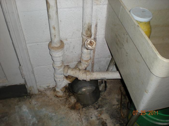

You must read minds. This house (circa late forties) has block walls with a brick face. The drywall is against the block (maybe with furring strips as an electrician had trouble pulling a line for the GD).
The drain pipe this is on (dedicated) runs along the block wall below (basement laundry room). There is major blockage and leakage on this line. It runs downwards parallel to the vent. The kitchen sink line is on the right (painted ABS) and the vent on the left (painted galvanized) both going into a hubbed CI pipe @ the slab. The galvanized tees are leaking (corrosion) and I was going to tear both out to the hub in the slab and replace with NO HUB CI and PVC.
Now, can the drain line and vent be combined (wet vent) or must they stay separate?

The vent must remain a vent.
You cannot wet vent an upstairs kitchen over a laundry tray.
What you can do is remove the pipe going into the 2" cast iron hub, and pipe with 2" from that point.
The vent to the left, is reventing upstairs above the hight of the kitchen counter.
For every pipe going down, there is a pipe going up through the roof. That has never changed.

Thank You Terry...
So the laundry tub is plumbed correctly by going directly to the vent base (sanitary tee) and not into the actual kitchen drain pipe?
Yes,
What you have is done correctly, but to the old sizing.
In the current code, it would look the same, but use 2" for the kitchen sink drain, 2" for the L/T and 1.5" for then vent. But the layout is correct.
The trap arm and the p-trap for both sinks will remain 1.5"

One last question-
Would it be permissible to empty the LT drain into the kitchen sink down pipe (sanitary tee) as to permit easier wall finish (framing) (moving the drain pipe closer to the wall) at a later date?

If that were allowed, that is how it would have been installed originally. You cannot do it now, either.
Maybe they were not concerned about how far the plumbing rough-in stood out as there were no plans to finish the wall?
Shown is a somewhat similar application (I believe) I came across where both a vertical and horizontal drain are included into one main drain, the PVC on the right (vertical) being a dry vent.
