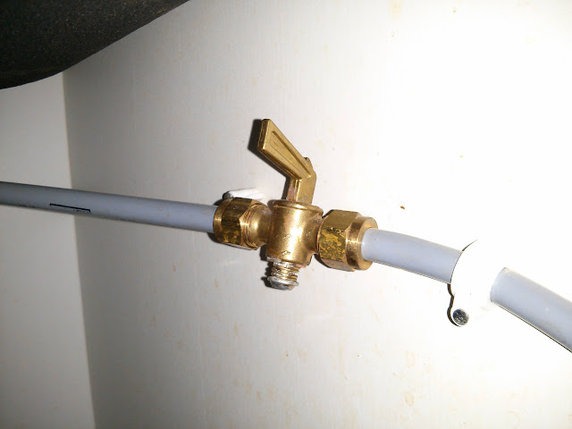

Please excuse my beginner level question but I am trying to save myself $125 to have a "Sears technician" come and disconnect my refrigerator's water line for me.
I found the shutoff valve under the sink, as done by the previous homeowner, but I can't determine whether it's a ball valve or not. It looks like it could be a saddle valve as well.
I assume once I figure out how to shut off the water via the valve I can then simply disconnect the wiring harness and water line from back of the fridge.
Any help for this new DIY'er would be greatly appreciated!

There will be some water in the line so be prepared for some to leak out when you disconnect it at the frig. You might want to open the valve to relieve any pressure first in the frig's door.

The line is normally a 1/4" OD tube.
You can pick up a shutoff for that at a hardware store.
The copper line is the easiest to cap or install a shutoff on. The plastic line will need and insert inside the pipe if it's a compression fitting. They do make a sharkbite type of fitting that just slips over the tubing.
You will need to locate a shutoff for the home first.

It would be foolish on your part to disable the ice maker. The connection kits sold by appliance dealers are mostly junk. They use saddle valves to connect to the water supply and plastic tubing. The best connection is made by tapping into the water supply with a tee into a ball valve. You then use fittings to reduce the ball valve size to 1/4" copper tubing which then goes to the kitchen. At that point, you should transition to a flexible line that will allow the refrigerator to be pull out from the wall without damaging the connector. The plastic lines are not unsafe health wise, but can get brittle and break. Copper is far better. Saddle valves are really crap. This installation is not a highly complex job, but you do have to be able to do some basic things. A plumber could do this very quickly.
