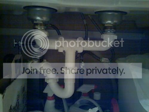

    Hello all. I apologize in advance for my lack of knowledge of the correct terms. I hope my descriptions will paint an accurate picture.
    I'm struggling with this issue as well. At present, I have two sinks, no disposal and a dishwasher that was draining on the wrong side of the trap. Each sink has a horizontal pipe that runs to a central piece that then sends the water vertically down to the j-bend. I tried to put the piece with the branch between the joining piece that drain from the sinks and the j-bend, but even after sawing down the bottoms of both the fitting and the branch piece, they are a maddening 1/2" too long for the j-bend to meet the . Now I see why my father-in-law put it where he did when he installed the dishwasher :)
    Is it possible/legal to put the piece with the dishwasher branch in a horizontal position in place of one of the horizontal pieces before the join?
    Here's the old configuration for reference:

    Yes it is legal, but you will have to use a Wye instead of a T
  16. sparky828
    sparky828 New Member
    Joined:
    Apr 18, 2008
    Thanks much for your response, and this where I further confirm my ignorance. I'm guessing the difference between a Wye and a T hinges on the angle at which the stem comes off of the tube. If that's what it is, then I think it's a Wye I have (the perspective in the picture above is misleading).
    This is the piece I'm thinking of using (already partly cut in my previous attempt to fit it vertical):
    [​IMG]
    Wye? Wye not?
  17. krow
    krow Plumber
    Joined:
    Feb 11, 2008
    Occupation:
    Location:
    Ontario, Canada
    That will work if you have enough space in the horizontal (probably the right side , judging by your original pic)
