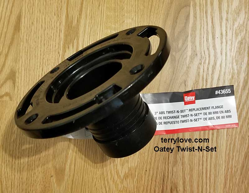

To use this, would we just cut off the flared part of our existing flange and push or twist it in? Thanks!
The flanges I had pictures of drop into the existing flange. They install over the old one.
Or you can take measurements and see what fittings and flange will bring it to where you want it.
