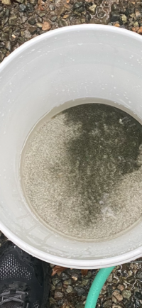

I ran my outdoor hose faucet wide open for a bit yesterday and filled a bucket, I got a fair amount of chips in it, they seemed to slow down after a while until you stopped for a bit and ran it again say half hour later then they just kept coming.

I’ll get some pictures of the material that’s coming up posted tomorrow, I hope im describing it accurately. In a previous career I worked for a mining company running a rock drill, the material coming up looks like the rock chips produced during drilling.

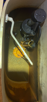

I’m afraid I’m not accurately describing what is coming up in the water. I tried posting a picture but I wasn’t able to (file was too large). I guess chips are not the right word to describe it, maybe very course sand like in consistency with a mostly granite like color. Very course stone dust?
38,903
4,437
Make the picture a JPEG/JPG max 900 pixels each way, and 200 kB or less
Sierra90
Virginia
One is of the toilet tank the other is a bucket from my outside hose faucet. I reduced the image size hopefully it’s still clear enough

If stuff like that can come from the tank, you certainly don't want a larger tank as that would just be a larger problem. 40 years ago I would have recommended the largest tank you could afford or get through the door. But that was 40 years ago and a lot has changed since then. The only purpose for a pressure tank is to limit the on/off cycling of the pump, which is bad for the pump, the pressure, and everything else. When you have a Cycle Stop Valve to limit the cycling, you don't need much of a tank. We could replace the tank and everything you have with a 4.5 gallon tank as comes in the PK1A kit.
