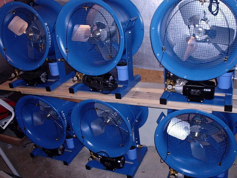

Here's a picture of what I'm tending to:
I've already in talks with the athletic associations in 3 counties to provide these for the school systems. What is magical about all of this is I'm building flat slot panels on the top so the schools can sell sponsorship/advertising on these whereby they can offset the monies spent leasing them from my company.
