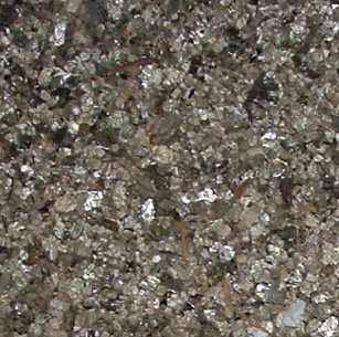

I'm cleaning up the crawlspace in advance of having some work done down there. Not sure if what this is, but there's a "blanket" of soft fuzz down there on top of everything. Is that asbestos?
FYI, there are lots of cobwebs hanging from the floor joists, and I'm hoping the blanket is just dust and cobwebs. The house was built in 1940 (stucco), and the crawlspace is under an addition that must've been done sometime after that. So maybe there's been a long time for things to pile up.
Otherwise I've seen no evidence of asbestos. Just that corrugated cardboard thingy in the picture makes me suspicious.

If it's a batt material bonded (however weakly) to the corrugated, it's far more likely to be rock wool than anything else. I've seen thin batts of horse- hair with heavy kraft facers on both sides that looked a bit like the material in the picture.
The most common loose insulating material containing asbestos would be vermiculite, which is granular, and shiny/sparkly. Asbestos used for pipe insulation was white/gray and fiberous, but usually coated with a plaster type adhesive. Thin sheet asbestos materials were sometimes bonded to ducts or other metal surfaces, and is normally gray, sometimes with a bit of obvious weave texture, sometimes smooth. Karstolite loose fill asbestos was fibrous, but not quite as "fluffy" as the stuff in your picture. If it's asbestos it would probably be Karstolite, but I'm not convinced that it is.
Loose fill Karstolite:
Similar loose fill asbestos:
Vermiculite/Zonolite looks like this:

Thank you. I'm really hoping it's just 60+ years worth of dust and spiderwebs that's built up.
I did actually find a wrapper(?) that said something about rock wool, but I couldn't figure out what that was. The odd thing is there's no insulation down there anywhere (maybe the floor used to be insulated and somebody removed it, who knows).

I suppose if you inhaled 100% of the dust in the picture and it were all asbestos there would be an increased risk, eh? :confused:
We don't know that it's asbestos in the picture, and I strongly suspect that it is not. It doesn't look very much like the commonly found asbestos insulation products. It DOES look like rock wool fluff and a bunch anonymous amorphous grunge, none of which you'd want to be inhaling during a clean up anyway.
