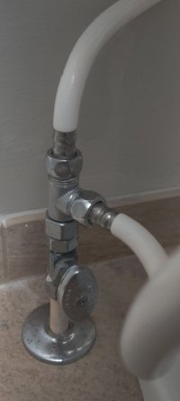

I am re-installing a bidet toilet seat in our new home. It has a t-valve that is meant to be connected to the angle stop. Here's what it looks like:
In our previous home, the female 1/2 inlet attached directly to the stop valve, but this house has a stop valve with a 3/8 compression outlet. Is there a fitting that I can attach to the stop valve that would allow me to directly connect this t-valve to the stop valve? Am I correct in assuming that what I need is a female 3/8 compression to 1/2 male pipe fitting? I do have it connected with a bit of a messy work-around. I have a short supply hose with a 3/8 female compression fitting on one end and a 1/2 female pipe connection on the other. I connected the hose to the t-valve using a 1/2 brass nipple. As a result, I have a bunch of hoses lying on the floor next to the stop valve. Ideally, there would be an adapter that would sit between the stop valve and the t-valve - but I can't find one.

You can use a 3/8" compression x 1/2" MIP adapter plus a short length of 3/8" OD tubing. But for an adapter that would go directly on the valve, you'd need a so called 3/8" female compression connection, which are mostly just on supply lines. The tee at the toilet fill valve seems a better solution.

What I was hoping to find was a bushing that had a 1/2 mip thread to fit into the female t-valve and a 3/8 female compression thread to fit on the stop valve. It would look like this, but the 3/8 threads would be compression not fip.

Thanks, I thought about using two fittings, but I actually found an adapter that is 3/8 compression female on one side and 1/2 mpt on the other at Ace Hardware.

The adapter seems to work fine. The one I used was sent to me by BioBidet but looks just like the one from Ace Hardware. Like a 3/8 supply hose, it has a washer, but it was easy to connect to the valve. I used some Megaloc on the male threads, even though most folks say not to, hand tightened the adapter and then gave it about 1/4 turn with a pair of Channelocks. I then followed the same procedure to attach the tee to the adapter. I opened the valve, and everything works as intended, and nothing leaks.

Female compression joints are meant to swivel. If the threads won't spin independently of the tee then when that hose is bumped it'll come loose. Give it some time and then let us know.

I think I see where you're coming from, but I don't think it applies in this case. The nut on the bottom of the tee does spin independently of the tee. If you look at my photo in the earlier post; if I want to reposition where that horizontal hose is pointing, I can grab the tee and turn it without the nut on the bottom of the tee moving. (Actually, If I were trying to move it counterclockwise I would hold the nut just to be sure, but the nut is designed to allow you to rotate the tee without the nut moving.
