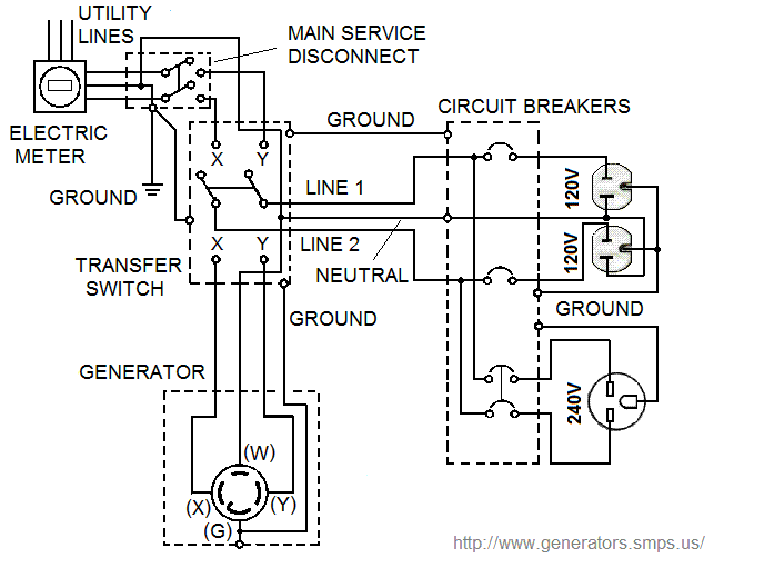

    I have a Flotec 1/2 HP 230V Deep Well Submersible Pump with a 19 gallon pre-charged bladder/tank. I'm exploring several options as to how to address when we lose main power and we lose our well. I have a 5250 watt generator and of course the first thing that pops into my mind is simply run a wire from the generator - problem solved! Before I go that route I wanted to look at a different solution in regards to backup power for example using in series/parallel 24V DC with an inverter and free the generator strictly for the house itself. The home we have is a repossession which we're restoring. On the outside of the house is a separate breaker for the well pump; it's a 40 amp breaker which given the fact I have a 1/2 HP pump and the specs say it pulls 5 amps. Watts equal Volts times amps or 1150 watts. A well pump does not run constantly but at the same time, it will come on at unpredictable times based on use. I want my solution to be unattended, so when I lose power I don't have to worry about losing water. There are simpler solutions like using a 1500 or 2000 watt inverter hooked up to a running vehicle but I'm curious if there's anyone out there who has dabbed into backup power and powering their wells and is the wattage I've calculated correct? Thank you.

    Not quite automatic, and you will have to watch how many things are on at once...
    [​IMG]

    Motors have two current draws.
    1. Starting current
    2. Running current
    1/2 hp = 370 watts, but I would use the 5 amps just to be safe.
    I would suggest not worrying about loosing water.
    I use a 3000 watt UPS for my computers, but what is wrong with loosing water?
    I have a 120V well pump, a 3000 watt UPS and yet when I have a power failure, I don't even care if I loose water.
    If I have to... I can start my 4500watt generator and back-feed power.
    PS: They make this simple leaver that mounts on your main panel where you have to turn off the main breaker in order to turn on the generator back-feed breaker.

  6. SnittyKitty
    SnittyKitty New Member
    Joined:
    Sep 4, 2008
    Thanks for your replies
    1st Bill - Thank you, you're referring to a double pole switch or some kind of manual/automatic transfer switch, correct? Three thousand watts for your computer?
    2nd, Bob - Thank you, before I opt to install a manual transfer switch, I wanted to explore alternative solutions that kept my well off that generator or if need be buy a generator sized specifically for the well or run an inverter from a vehicle to do the work. You're exactly right, the only way to pull water is to go outside and fire up the generator to fill the bladder, but as you see to run the generator any longer is wasteful.
    It crossed my mind to use an inverter, but then again, that too might be defeating the purpose too. Bill has indicated to me that 1/2 hp is 370 watts and if only 370 that plus a factor of 1.5 for startup of the well pump or round numbers, 600 watts might be all I need to accomplish the task.
    I am by no means an electrical expert, but my pump is 230V, I'm not aware a small inverter has a 230 outlet, though I've read something about stacking the inverters, but neither am I one to play with electricity for the sake of experiment; frankly I wouldn't know how to do that or make the attempt unless I'm positive I can do it right the first time.
    I want to explore the idea of using a 24 volt battery backup system that would use a trickle charger to keep the battery(ies) charged and an inverter. Power outages have never lasted more than one day where I live and that ideally is what I'm looking for.
    Is this feasible?
    Thank you!

    I work at home and have to run lights and equipment off of the UPS along with my File server and water based computer cooling system.
    1. Pumps don't like the square wave that most small inverters use.
    Modified sine wave = square wave with a zero volt gap.
    2. You can't tie multiple inverters together.
    3. You can use a step-up transformer to convert 120 volts to 240 volts IF the UPS puts out a "true sine wave"
    FYI: A 1000 watt Toroidal transformer is about $150
    4. The 5 amp number is probably it's start up current, This means you need to be able to produce 1200 watts to get it to start.
    If you want to go the UPS route, Your best option would be to find a used UPS with a "true sine wave" output.
    FYI: I payed ~$600 for the 3000 watt "true sine wave" output UPS I use, but remember that batteries will go bad over time and used UPS's generally need batteries. I got luckily in that the eight 12-volt batteries in my UPS have lasted over 6 years, but it's only a matter of time...

    I don't know how electronically/mechanically adept you are, but yes it can. If you don't have the skills don't do it. These people http://www.atkinsonelectronics.com/ have a control for running the generator. It needs a single input for start/stop. The controller would need power. You could probably get that from the generators starter battery. You are going to have to figure things out and rewire some stuff.
    The problem is getting that signal. If you pump had been 120V you could have used the second set of contacts to run the generator. A 1/2 horse motor could have been built to run on 120V but from your post it is 140V. Simply using a second pressure switch would be too dangerous. It is not likely to exactly track another switch and could keep the generator running when the pump is not on. I do not remember seeing a switch with more contacts. Try searching the manufacturers site and see if you can find one with one more contact. If there is one for 3 phase that would get you the extra contact. If you can find one, replace the existing switch. This is the best way.
    You could put a microswitch up against the moving part of the relay. You need to find a way to insulate the device. Then that, with a small DC voltage, would control the box. Again you may be able to use the generator battery. One caution is that while actually cranking the battery voltage will drop. Make sure the voltage does not go low enough to make the control signal stop the generator. Look at the current and voltage needs of the controller and you may just be able to use regular old flashlight batteries to power the signal line. One could also use a LED/photo transistor to control things by sensing when the moving part blocks the beam. You can get a small assembly with a slot in the middle to do this if you can find a good place to install it on the pressure switch. That will need a bit of external electronics. Another possibility is a small magnet on the armature and a reed relay mounted and adjusted to pull in when the switch closes.
    You probably want to use a larger than normal starter battery. You will be starting without running long enough to recharge the battery. The controller will monitor the battery voltage and run the generator when the battery needs to be charged. This is also probably a real good thing for generator life, but I assume you won't be using it all that much.
    You must use a transfer switch. If you run the generator only when the pump needs to run; what will you do for powering the house?
    WARNINGS
    Remember - you are messing with 240V on that pressure switch. You must use an approach that will not carry that voltage outside the cover of the switch. The moving part of the switch has a lot of exposed surface that is live.
    Make sure that the generator exhaust can not get into the house. Has to be outside, away from building air intakes and operable windows.
    You must have a transfer switch. The generator and switch must absolutely prevent the generator from coming on either with the grid power on or the grid connected when power is off. In the first case bad things will happen to the generator. In the second case you could kill someone.
