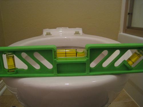

A nice picture of an American Standard bowl.
Would you want this in your home?
Plumbers and homeowners shouldn't have to inspect and open every box before they bring them home.
That should be done by a factory inspector.​

Here's a picture of a guy sitting on a leaning A/S Champion bowl. It's a good thing he's wearing pants otherwize he wood slide off.
