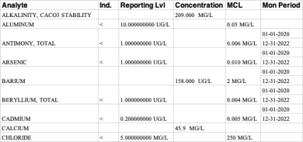

I really don't know for sure but the engineer told me they just pump it out of the well into the water tanks (there are 4 around this small town). The DNR report does show some chloride, so apparently it's added somewhere.

Common salt is sodium chloride, so that chloride number does not indicate a disinfectant having been added.
You might ask one of the people if they use chlorine or chloramine in the water as a disinfectant.
