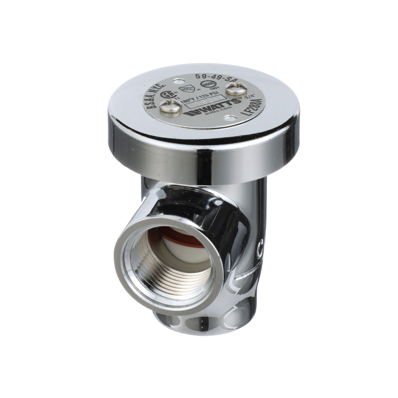

We are installing this Kohler deck mounted tub filler K-26441-4-2MB which has a handheld. The handheld is required to have a vacuum breaker which is not part of the Kohler valve (confirmed in the instructions and with Kohler tech support). Does anyone have any ideas on how to get a nice looking vacuum breaker to fit this scenario? I know they make them for shower handheld showers K-9660-2MB, but I believe that they dump water when turned off which will likely just leak under the tub.
*Note* the installation instructions mention a Sioux Chief 652-AD VacuRrestor for vacuum breakers and they mistakenly refer to that device as a vacuum breaker, its not, its just labeled incorrectly in the Kohler instruction manual.
The code sections (UPC 417.3 or IPC 424.2) don't call out a vacuum breaker in particular, just an ASME A112.18.3 backflow prevention device. Not my area of expertise, but it appears there are dual check valve devices that meet ASME A112.18.3. So maybe you can install a dual check valve or similar backflow preventer that won't discharge water?

no way they make em in that finish. chrome or rough brass, all ugly. there is a check valve already on that Kohler faucet.
WHammer arrestor is nonsense.
Normally recognized as not needing backflow prevention because when water flow is shunted to the sprayer, the spout opens, thereby preventing backflow completely

I'll have to do more research in what types of double checks I can install that are reasonable to install. I really don't want to install this style of double check
which requires maintenance and I believe that these require specific location restrictions for testing.. ie, can not be installed too low or too high.

The way I'm understanding this is a hand held sprayer is able to be held below the flood rim of the fixture. Meaning there is no air gap for the handheld and it can theoretically be held under water and back flow bathwater into the piping.
Can you put a clip on the hose so it can not be pulled out far enough to infringe on the air gap requirement but also be reasonably used?
If not there's no way other than a typical vacuum breaker for a handheld shower. Along with a ball valve type of shut off so it doesn't spray on the floor when not in use.

Unfortunately the handheld will always be able to fit under the flood level since its deck mounted. I know functionally the diverter will be an effective means of backflow. Once pressure is turned off, as in a back siphonage scenario, the diverter will default to the tub filler effectively creating an air gap. But I want to have some Ace in my sleeve in case the inspector pulls the Diverter is not an approved device card. Something that is installed, looks appropriate and I can leave in place is preferable, but another undercounter non spilling device would be a close second option too.
The location is a city that I believe the plumbing inspector is also the building inspector, so I'm assuming they won't know too much about backflow in this scenario, so likely a moot point.
