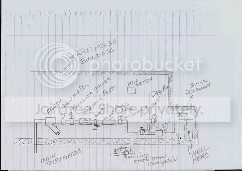

First attempt at image download. Hope it's image code needed. This is diagram of what I would like to do in the well house. Would like critique of layout

Lol, nice! To clarify, my personal pumps are just part pumps that I have little to no money in. Every now and then I'll get a buddy that wants a pump on the cheap, so I'll give him mine (been using it and know it's good) for a small fee and put on another part pump. these are jet pumps of course fed by an artesian well with natural pressure. Most of our submersible systems include CSV though.
As for the picture, after the CSV and switch, A typical irrigation system around here would have 2 lines with cutoff on each line.. One irrig, one all other... that's it. I don't know much about tree farming though (injection? Will u be running chemicals through irrigation as well?) so maybe u need all the other stuff.. wish i could help more there.

justwater, with drip irrigation you have to be able to inject either chlorine for algae or acid for Ca+ buildup. Since I have to use emitters @1-2 GPH. it's pretty easy for them to clog up. If I had more anticipated water flow than 10 GPM, then I would use micro sprinklers. I hope someone here has knowledge of both well & irrigation to keep my plans on course...du

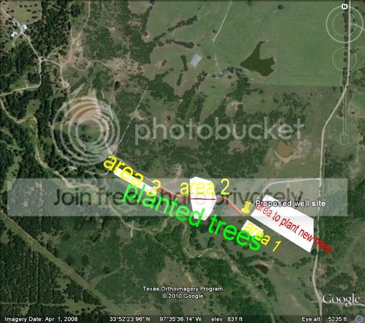

If this were a typical layout, then additional zones would be more feasible
But I am planting trees along a creek in random areas over large distances. That's why I am using a irrigation designer to size the pipe and do a take off...du Thatguy, thanks for the links. I have read everything on the second link, but the first is a new one.. thanks again..du
