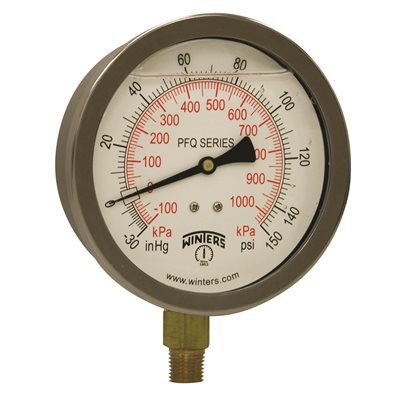

It would interesting to have a combination vacuum pressure gauge on the upstream side of that check valve. Would the vacuum be maintained, or would it go away with time? If there was no above above-water hole in the downpipe, then a missing or failed check valve down the hole would cause the vacuum to be maintained. If the vacuum went away, then there would be a hole. That hole could have been put there on purpose for use with a "conventional" galvanized pressure tank. Did the old topside check valve have a Schrader valve on it by chance? Or did either check valve have a plug that could be removed and replaced with something else?
In any case, pulling the pump would be your longer term solution. To use a precharged pressure tank, you would remove the bleeder hole, if any, or put a working check valve above the pump. For now, the topside check valve is a good workaround.
