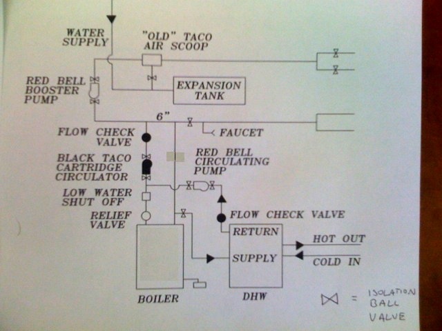

I am having two major issues with a 3 year old WM ultra boiler and indirect HWH. The system has seriously underperformed since having it installed and I'm worried something is majorly wrong with the installation. When I first had the system installed the HWH was pumping 180 degree water to our house faucets. They replaced the aquastat then eventually the hwh completely. Well the scalding hot temperatures are back and that's not all. Several people I talked to thought this was a bad aquastat again but I talked to WM rep and tested the one I have and it works properly. Along with the hot boiler temperatures, the boiler will not heat the house well when its 30 degrees. Our house will drop from 70 to 62-63 degrees overnight. I am very worried about these issues with having two, two year olds.
Today, I stood by the boiler for about an hour and tested a couple things. Firstly, I was able to activate the house zone and HWH zone while the boiler was in the standby setting. But in both cases the boiler just went from "Prepurge to Ignition to DHW/FTB to Postpurge" in a constant 1 or 2 minute cycle. The boiler didn't fire and the circulator pump for the activated zone continuously pumped. This I can remember happening the whole time we've had the boiler (again mainly at night).
I'm confident this issue along with the system heating the hot water boiler zone to 180 degrees is malfunctioning the entire system. At times it works properly but overall its a big mess. Our boiler worked for a short time today (well it heated the house), which is the confusing thing to me. It seems like the vast majority of the day these two issues arise which is certainly which is causing the unit to underperform.
Any help you could give me would be greatly appreciated. The installer is not helpful.

There isn't a mixing valve and the WM rep was surprised by this. I noticed they aren't required in the installation manual although they are recommended. If I get this resolved I'm going to put one in myself.
The company that installed the boiler pretty much did bare bones installation. They left an old taco air scoop from my old boiler and an old steel water tank that isn't diaphragm or bladder (as required by the installation manual). I was thinking this was causing some issues with my system but I have never heard air in the system and the air vent doesn't seem to ever weep water. The air vent on the HWH does but I believe only because the temperature is so high.
I wish they installed an outdoor reset. Even after asking they told me it was more trouble than it was worth. Ditto with piping the air intake to the outside.
The pressure when the house zone is going seems ok 11-12 psi. The pressure when the HWH is going bounces around a little bit from say 13-15 psi.
I believe the primary loop is the house zone circ (I only have 1) and the secondary is the HWH circ. Although my knowledge is sketchy in this area. Could the issues stem from a wiring issue?
Not sure if this helps, but here's a link to photos of the install and a diagram.
http://ringo311.wordpress.com/boiler-photos/

Ok, so a serviceman from the installing company (not the person who installed it) came over to the house today to diagnose.
Firstly, he took out the igniter and cleaned it off and the boiler started firing.
He also checked the programming and there appeared to be an issue. The system is set up as primary secondary with 2 zones and 2 circ pumps - 1 zone being the hwh and 1 zone being the house radiators. When the house zone fires the primary pump and zone pump are both activated. For the HWH, only the zone pump was set to activate when the HWH demanded heat. He turned that setting to activate both the zone pump and the primary pump.
He said this would probably fix the malfunctioning hot water heater. We shall see. The house is heating and I am happy for now. I am thinking of replacing the igniter.

In wet-head hydronic heating terms the "primary" is the loop that is pumping water to & from the boiler, and the "secondary" is the water that pumps to the radiation. Where the loops intersect is either a component called a "hydraulic separator", or in your case, a short section of fat pipe with closely spaced tees at the primary/secondary branch points. This allows the the designer to set different rates of flow for the boiler and for the radiation, which is sometimes necessary (but often not, on single-zoned systems like yours. The loop to the indirect appears to be independent, and agnostic of the state of the heating system (it'll run even if there is currently a call for heat from the house thermostat), unless both the house thermostat and the tank's aquastat are wired to a zone-controller rather than pump relay.
It's possible that the check valve on the loop to the indirect is letting water bleed through, or if the primary pump is pumping away from the boiler (flow direction isn't indicated on your diagram for either the primary or secondary pump, but direction is indicated by an arrow in the casting on the side of Taco pump body) it would always be pumping some hot water through the indirect whenever the space heating was active (just at a lower volume than when the indirect's pump is active.) If that's happening and the boiler is delivering 180F water the indirect would slowly heat up even with it's aquastat set to 120F. From your pictures it looks like the black Taco on the primary is pumping toward the boiler, but I'm not 100% on that.
