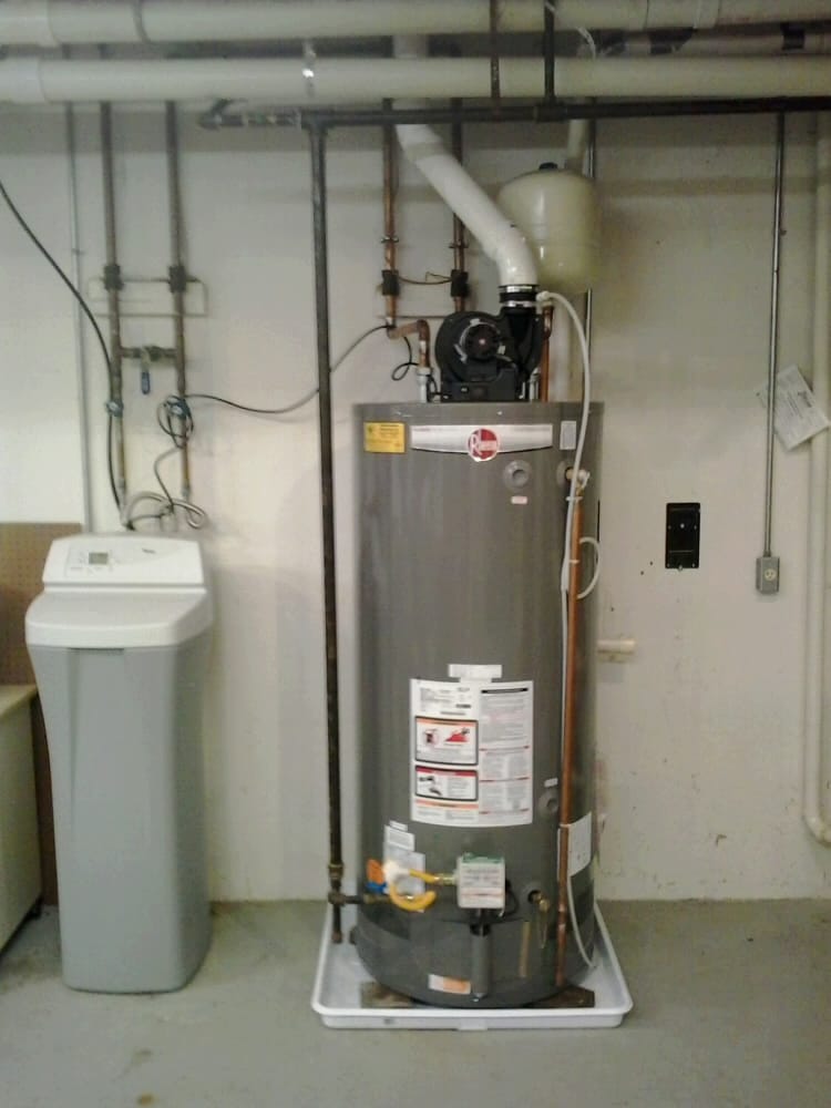

you would do well with the 75 gallon Rheem unit.. we are pretty happy with them so far
and have gotten a pretty good life span out of them.... just throw w thermal expansion tank on it
and it should last a good while....
Remember , you can always turn the 75 gallon gas heater up on HIGH too if you really want
to provide a lot more hot water....

I must be getting old :) That's actually purty! I have resisted the power vent for so long I lost objectivity. I have clung to our atmospheric vent mostly due to passive means nothing will break. But once I get past that and accept a hole in side of garage, going with this is no doubt the simplest most cost effective solution. The Phoenix unit looks to be made well and will probably last longer. But if we only stay here 5 to 7 more years in this home a standard 75 gallon power vent water heater starts to make sense.

Thx for reply and good catch. I went back anbd checked the specs for the system we actually had installed in 2008. I did have a quote for a 96K system but did not go with that supplier. The system we installed is a 70K BTU Bryant 2 stage gas furnace for the upstairs system. So a little less BTU to factor in.
I will double check later to make sure I am not lying but I believe I have the existing water heater output maxxed out on temperature. It is quite hot when it starts. I just don't get enough heat in winter to fill the tub. At one time Bradford White made a 60 gallon lower BTU water heater but it was very expensive and I did not feel secure enough to go with it. I don't think they make it any longer.
The most cost effective solution sounds like a power vent AO Smith or equivalent 75 gallon water heater and more than likely an upsize to the gas line if needed. The Phoenix Lite water heater would offer a faster recovery albeit with a water heater brand that potentially could be harder to find service if needed. The polaris and Vertex models start becoming pricey.
I agree that a tankless would be an exercise in tedious for the tub. Can imagine slow would be the operative word and getting to 199K BTUs would not be cheap. I need to check my existing gas line but it may be able to supply the 76K BTU wise. No free lunch. Had builder installed a 4 inch vent I could look at atmospheric vented models.
The furnace is still ridiculously oversized for most houses. That is enough burner to maintain 70F indoors in my ~2400' (+ 1800' of insulated basement) sub-code 1920s antique down to about -45 to -50F. (If I moved my house to Fairbanks AK that would be about right!) A typical 2500' 2x4 house built in the 1990s with clear-glass double panes and R13s in the walls, R25-R30 in the attic would have a heat load between 25,000-30,000 BTU/hr @ +15F (the 99% outside design temp up in Henderson), less in most of the state. There will be exceptions both below and above that range, but you'd probably have to crack some windows open to see even 50,000 BTU/hr unless its the air-leakiest house in NC, or maybe if the ducts & furnace were in the attic above the insulation, and leaking at the seams. Even at low fire the thing is probably more than 1.5 x oversized for the actual load, (not that it's worth swapping out until it's dead.) If the house is more like ~5000 square feet it might be right-sized.
Just about any 75 gallon hot water heater would have you covered. Most will have burners north of 50,000 BTU/hr, many north of 75,000 BTU/hr (to avoid having to EF-test it). If you're only going to be there another 5-7 years there's no "payback" in going with a condensing hot water heater.

I wrote HTP last night via their on line form. Have not heard back yet but I was curious if there were any installers in the area or if I would have to buy the water heater, have it shipped and then find an installer. The latter would be avery near fatal. Not answering in a reasonable time period is the same!
any Rheem plumber should be able to install this water heater . its no big deal.
its not extremely hard to bore a hole through a garage wall for a 3 inch pvc pipe
You can go up to 60 feet if necesary
the hardest part is to make it look civilized on the outside wall
It just takes a couple of dummies to lift the thing up on a stand
or being its a FVIR unit, just install it on a couple of 8 inch concrete blocks .......

I am curious though as to how loud the blowers are on either the Rheem or AO Smith. While the water heater will be in my garage, our main entertainment room is the room over the garage. Is impossible to gauge how loud anything is by watching a video but some subjective feedback is appreicated.
1,193
The spec sheet likely lists the sound level. Some people do find the noise objectionable, but that very much depends on where it is relative to where you are and what else is going on at the time.
But, the things generally don't come on often to just overcome standby losses, and often, in the morning, you may be leaving afterwards, and if in the evening, it's more likely before you go to bed, so it would then depend on how far the bedroom is from the thing verses the entertainment room (where you'd likely have the TV or stereo on).

Thanks. The Rheem sheets list new whisper quiet blower fan but nothing about decibels I can find. I had seen several complaints about loudness but also realize that is subjective. The water heater is directly below this room but off to the right hand corner. Stereo would easily block any noise but TV might possibly be affected. Should have no impact on bedrooms whatsoever. Probably a nothing issue but figured is free to ask before buying!

after you put a pipe out of the home you simply point it downwards with an ell...
and possibly extending it closer to the ground...Ideal location is about 20 inches off the ground
the sound seems to muffle and gets absorbed by the earth.....
we have never had a problem with the newer units....

I have seen many water heaters installed in garages with only a
3 inch vent when it should have had a 4 inch one.. Someone just installed a 4x3
reducer on top of the hood cap and away they went with it..... Being in the garage
it did not matter because of the open ventilation...
You are making a federal case out of this . The power vent will not sound much louder than
the furnace does when it comes on ....
