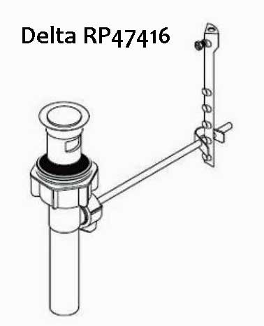

    Recently had two new Delta vanity faucets installed with pop-up drain plugs. In one sink the pop-up plug is not sealing properly - upon filling the sink one can hear water slowly leaking into the drain. Tried just pressing the plug down but didn't help. Thought it might be an installation issue, but the plumber removed and re-installed the pop-up and the failure to seal completely continues. There is no obvious problem with the rubber(?) on the pop-up (no nicks, bumps) , nor does it appear that there are imperfections in the metal drain part in the sink. Is there some quick fix to try to get this thing to seal? Should I be calling Delta and asking for advice or a replacment plug part? Thought I'd ask here first. Of course it is the sink on which we want to USE the plug that there is a problem!

    Change the pop-up with the other sink pop-up. If they are the same. I would try that as a test.
    If the pop-up assembly is not installed right it will cause the pop-up to not move into place properly.

    It sounds like someone forgot to seal under the drain flange with plumbers putty!

    Last night I took a look at the Delta website and in their FAQs was a question about pop-up leaks. The flange issue was mentioned as a possible cause of the leak. I carefully poured water around the flange and water drained on one side - right under it! The plumber is on his way to do the repair.

    Actually the root problem is that the faucets were bought at Big Box Store and they have that cheesy plastic drain assy that big box makes them use. They come with a thin rubber gasket that allegedly seals under the flange and some poor sap working for a rooter company believed the directions...

    Not sure what the original installer used on the sink that didn't leak, but the second guy definitely used silicone. Guess it will be a pain to remove should that ever be necessary. I know that I have plumber's putty in my rudimentary plumbing repair stuff, but I wasn't doing the install. (I have, however, replaced a drain assembly in the past, and am fairly sure I didn't use silicone). I just checked the Delta instruction sheet and see that they say to put silicone under the flange - no mention of plumber's putty at all!
