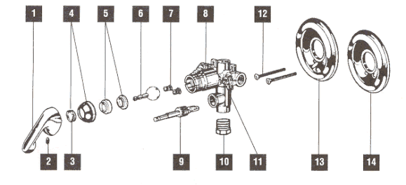

The shower is a delta. This may not be the actual model, but this is the basic idea:

So, where do I check for the shower fixture? I already checked the head and it was clean. Hot sater very low flow, cold is good.
Do I just pull the cartridge and clean it out and flush the pipes? Do I need to buy new stuff? Do I need any special tools like one of those O-ring tools?
Should I just replace the cartridge?

You can pull the cartridge out and let the water flush out the valve body. If I were going to go through the trouble, I would have a new cartridge ready to go in.

I guess I just need to pull the shower catridge and see whats what.
would it be a bad idea to so the cartridge in vinegar or CLR for sediment removal?
