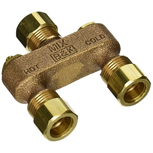

You can, however, control the water you put into it. I feed room temperature water into my toilet so I get zero condensation on my tank, resulting in zero mold and mildew "under there". Not to mention the dry floor and flange under it.

Warm water into a toilet isn't going to help a hard water situation at all.
It was merely an example of how I chose to do something unusual to a toilet, when a lot of folks would find the idea crazy. Who would put warm water in a toilet? Obviously enough to invent the Toilet Tank Anti-sweat Valve. I could have swapped a new toilet, where the tank is insulated. But I love my old toilet. It's my toilet, it's my house, I decide I want to keep it.
Cold water makes the toilet tank condensate. Just like a cold can of beer. The condensation stops when the tank has warm water. That's why your hot coffee doesn't condensate. I solved the problem by changing the water supply.
If you think you can solve your problem by changing the water supply, do it. Most folks only soften water for their laundry room, but you can do it for whereever you want to use it. Some people do choose to install softeners at the main valve, so their whole home is softened. It's not illegal, it's your home.
