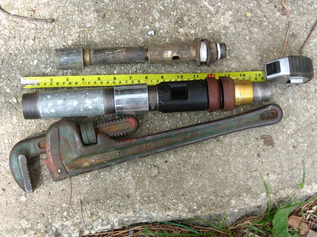

i've seen a picture of a 1.5" jet assembly but its extremely rare and i dont think you can find them anymore. so if it is in fact 1.5" casing.. i guess its more than likely just a single drop pipe.. that pump is a POS too, i'd get a good cast iron shallow jet pump if i wanted best possible results.

found the pic someone posted on another website that i can't mention. little one is a 1.5" jet (very odd), bigger one is standard 2".

Ja, notice the thinwall coupler on the 2". My father once made the mistake of using one made for electrical conduit which split under pressure.
Also, if using poly pipe, there is no room for gear clamps. I forget what they are called but one needs the kind that is installed with a special ratchet tool and then set with a hammer.
