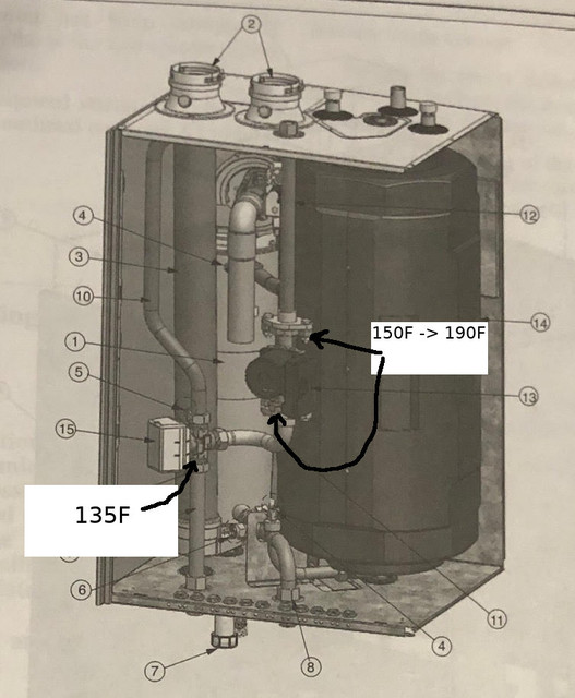

I am looking for help troubleshooting an issue with my Triangle Tube Prestige Excellence boiler.
As of yesterday it suddenly quit heating the Domestic Hot Water supply.
It still runs the Central Heating flawlessly.
Currently the TriMax interface status is "DHW Priority" meaning it is attempting to heat the DHW but the temperature of the internal DHW storage never increases beyond 62F.
The Boiler fires on to try and heat the DHW until the supply and return temperatures reach about 185F.
I appreciate any info
-Remy in Alaska
Remremrem
Alaska
In an effort to test if the pump works, I measured the temperature of the pump housing at the inlet and outlet and also the temperature at the valve union.
First I measured it after the DHW had been deactivated for over an hour. The pump housing was about 150F at both ends. The valve was about 135F
Then I reactivated the DHW and watched the pump temperature climb to about 190F on both ends.
The valve remained steady at about 135F
It seems like if the pump wasn't working, it would not have heated both ends of the pump housing so quickly, but I am not sure how else I can test the pump.
Is it possible the valve is not functioning?
