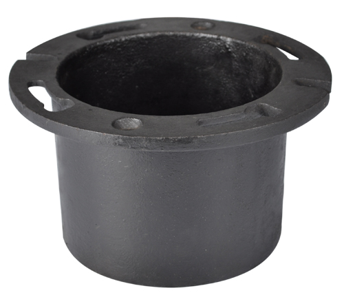

The old toilet flange ripped off my 4" drain pipe.
I was considering installing an Oatey PVC slide in compression flange but don't have a way to secure it (see photo). I filled the gap surrounding the flange with spray foam to form a base - the gap down to the foam is about 1-1/2" to 2" deep. (This is in between floors - so needed a way to hold up from dropping down to the ceiling slab of the next floor.) I planned to fill the rest with concrete.
I was thinking anchoring concrete but the pipe feels a little soft? Maybe that's just the old lead remnants near the top from the last flange? But I'm concerned that because anchoring concrete expands (per the spec sheet) that it might deform the shape of the pipe. Maybe it would be better using hydraulic cement? Or is there a better suggestion entirely?
Thanks for any help.

That looks like a soft LEAD pipe you are looking at.. it is not cast iron...
You have an old LEAD PIPE to deal with so its better to
get a CAST IRON FLANGE and make it grip to the concrete floor....
Also you might want to break out some more of the concrete
floor around on the back side of that pipe to get a more even hole to work with when you pour in the expanding concrete....
Then.... You should get all that foam out of the gap that you filled in..
go out and buy some hydrolic cement that quick sets up fast
go out and buy a 4 inch extra deep cast iron flange and fit it into the hole.
it should have at least a 5 inch deep or more reach down deep into the concrete ...
Dig out the floor around the lead and form fit the cast flange into the hole then fill in the area around the outside of the flange with a very soupy expanding hydrolic cement--- it will turn hot and
expand against the concrete and the flange wont move again...
Remember to work the flange down into the cement to the correct position
for the bolts to line up and work properly .
and then pour or use a stick or tool to get more down
into the center area between the lead and the cast flange
and what ever gaps you have left exposed that will harden up...
This expanding concrete will set up fast so dont fool around
once it sets up it should never move again.....
Most all of these flanges have
a slight lip on the bottom of the pipe so once the concrete sets up
it is gonna grip against the cast lip and not pull up .... or you can even
attach a couple of self tapping screws to the bottom of the flange that will
get buried in the concrete
tap the lead to the sides of the flange as best possible and then use a couple of wax rings to seal the deal down
it aint going anywhere
also , you can glue the toilet down with either silicone to the floor
or just normal caulking and it will never, ever move again....

For any of you interested, I hired a plumber who did a great job at fixing this repair.
He left the spray foam in tact that I had already put into the void as the base and then filled the rest with Quickrete. He covered the gap with a metal plate - apparently made by a company going out of business. The plate spreads out over the floor allowing for anchoring into the concrete and then provides locations for the flange to screw into. He dropped in an Oatey flange replacement, secured to the plate, added the wax seal and set the toilet. One additional step he took was using plaster to seal the toilet to the floor (instead of caulk around the base). He said this would give a much more secure setting for the toilet and eliminate any movement down below.
Ultimately he was concerned that the lead pipe may have exhausted it's life span but only a test would tell. At this point, seems all is well after several days use.
