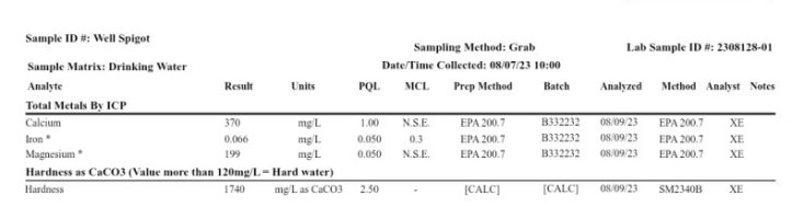

Hello,
I'm hoping I can get some help from you smart folks on a water softener rehab project.
We're on well water and I finally got the water tested, it's about 40gpg higher than I thought. Our water hardness is 101gpg. Our water softener has been installed for 20 years, and we've been in the house for 7 years. I changed the valve, but haven't done anything else. I've bypassed it since resin is coming through plumbing.
I'm open to any recommendations (even if it's drastic change from what we have now) and could really use the help.
This is what I currently have:
3.0 ^ft resin tank (tank & resin 20 years old)
Fleck 5600sxt (4 years old)
.50 gpm 1.5lb salt/min
Injector 1
Drain flow 2.0 gpm

Extreme hardness reduction will often utilize 2 softeners plumbed in series.
The initial softening stage will remove the most significant quantity of hardness, but to achieve greater salt efficiency, a lower than usually recommended salt setting will be utilized, which will result in higher than desired hardness leakage through the resin bed. The 2nd softener will then further reduce hardness to the desired level.
A twin tank softener will offer 24/7 hardness reduction, and as no reserve allowance will be utilized, the entire amount of capacity that is regenerated each cycle, will be available for use, which will further increase efficiency for the initial stage of hardness reduction.
Although a 14" diameter softener tank is larger than recommended for a Fleck 5600 based system, if your existing softener is re-bedded, it could likely be utilized for the 2nd hardness reduction stage, but the lower basket and riser tube would first need to be replaced as failure of the lower basket is resulting in resin to enter your plumbing system. With the age of the resin and as some resin has been lost, recommend re-bedding with 3ft3 of new resin + 30 lbs bedding gravel.
In addition, as previously stated, your existing softener's 2.0 GPM drain rate is too low, which will require the simple replacement of the existing DLFC flow restrictor, with a 5.0 GPM restrictor to allow the appropriate drain flow rate needed during the Backwash and Rapid Rinse stages of regeneration.
As this type of softening exchanges hardness ions (mainly calcium and magnesium), replacing with sodium ions, your softened water will contain an excessive quantity of sodium. A reverse osmosis system should be utilized to provide water for drinking and cooking as R/O is extremely effective for removing sodium.

Thank you for the replies, very helpful! Both of you mention a two tank system. I'm not opposed to investing into a different setup. I was under the impression that a 2 tank system was solely to circumvent using hard water during regen, sounds like there's more to it?
What would you recommend? A 9100sxt? I'm unclear on sizing resin tank(s) . Before posting here I used an online calculator that said I need a 283k grain water softener. I don't mind getting different resin tank(s) since the one I have is tan and let's UV light in, which is an issue where it's at in garage. I'm somewhat concerned about the complexity of a two tank system, e.g., 2 separate valves/meters. I'm wondering how that works in parallel or series?
Bannerman, you mentioned water containing excess sodium. Is this the trade off regardless of anything? We do have RO, but would still like the non-RO water to taste less like the ocean

With a single tank softener, at 2 am each night the controller figures out if there is enough remaining capacity (reserve) to make it until 2 AM the next day. If not enough remains, then the softener regenerates.
Suppose a nearly worst case scenario that you only get 1.9 days of softening for each regen. In that case, you would regen every day, leaving 0.9 days of softening on the table. So you are only using 53% of the resin, or you are using up to 48% more salt.
With a 2-tank system, the softener would use 1.9 days of capacity, and then switch to the second tank. The first tank gets regenerated and is ready to go when needed.
I was estimating you get around 2.48 days of capacity. The wasted salt is not nearly as bad. Not terrible.
You would like the softener to go for 7 or more days before needing regenerating.
For high hardness compensation info, see https://terrylove.com/forums/index....0-sxt-programming-settings.60651/#post-450189
Also http://media.wattswater.com/F-WQ-EngineeringGuide.pdf page 11 of 40
In my calculations, instead of using the table directly, I interpolated... actually I curve fit.
