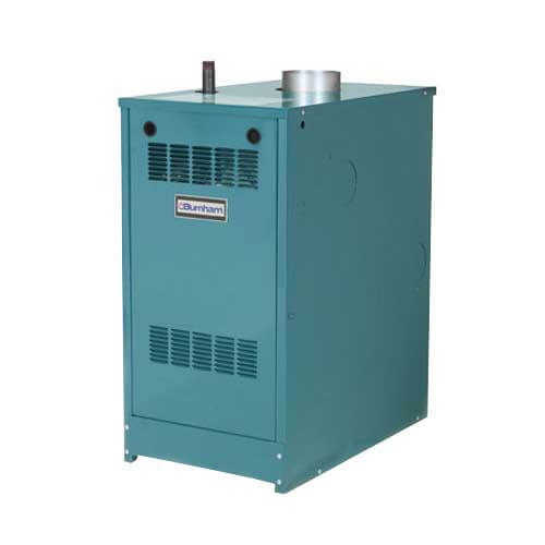

Should I replace my 53-year old Burnham gas boiler?
LMerriam
Hazleton, PA
Recently moved into a house built in 1967 that has its original Burnham gas boiler. Although it has been regularly maintained when I read that boilers are good for 15-30 years MAXIMUM I thought it would be wise to replace it before next Winter (it gets cold her in Eastern PA and can't imagine what would happen if the boiler failed midway through winter with 10-20 degree weather for days in a row). Got quotes ranging from $6,700 to $9,000. Gas company guy came by this week to check a suspected slow gas leak that we could smell in our laundry room (gas dryer). Turns out there was no leak and was probably just a smell from the washer overflow drain. Long story short, he checked the basement including the boiler and said it looked to be in really good shape. When I told him we planned to replace it this year he told me "You're out of your mind. This boiler will last forever and you're wasting your money to replace it." "All it needs is professional maintenance every two years and a brushing/vacuuming around the gas-tube-burner things inside once a year and showed me how to do it." So now I'm wondering ... is he right? Should I take my chances that the boiler could abruptly fail due to its age? Or should I replace it before the worst happens? Any advice is much appreciated!

That looks like an absolute beast - an 8 or even 10 plate boiler based on it's width. How wide is yours?
index.php
It looks like your front panel (the panel with the Burnham name plate on it) lifts out with hooks or now-missing knobs on the upper corners on either side of the vent louvers. The bent vane in the middle looks like somebody may have used a large flat screwdriver or flat wrecking bar to lift it up from the center, which may work just fine. The ratings plate is behind that panel.
That's probably on the order of 250,000 BTU/hr (in) or more. The current Burnham Series 2 P208 is 28" wide across the front of the jacket (dimension "B" on p.2) , drawing 232,000 BTU/hr, with a DOE output of 191,000 BTU/hr. If your fuel-use load calc comes in at the anticipated <35,000 BTU/hr you're looking at an oversize factor of 5 or more, which means it's average duty cycle is in the dirt, well over the cliff of the knee in the as-used efficiency curve.
A retrofit outdoor reset control probably WOULD work with your beastie-Burnham, but outdoor reset probably wouldn't increase efficiency much (it would increase comfort though). With some re-plumbing an outdoor reset controlled mixer could be used while still operating the boiler at a higher temp.
