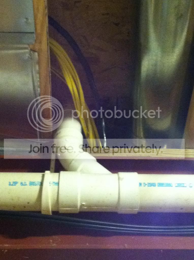

  8. Chad Schloss
    Chad Schloss Member
    Joined:
    Jun 18, 2010
    Location:
    USA
    funny, it passed inspection in 2006 when it was built. it is sold at the big box stores locally and the pipe is labeled DWV ASTM-2949 i think
    EDIT: It's allowed per your .PDF under table 702.3

  10. Chad Schloss
    Chad Schloss Member
    Joined:
    Jun 18, 2010
    Location:
    USA
    " I do not know how you would use it for a complete indoors system"
    The fittings that I see on what is installed here do not have an adapter. They use sched 30 on two ends and sched 40 on another. like I see a 3x3x2 wye and the 3" portion is sched 30 and the 2" is sched 40. Just for FYI

  12. hj
    Joined:
    Aug 31, 2004
    Occupation:
    Location:
    That is because they do not make "sch 30" pipe in 2".
