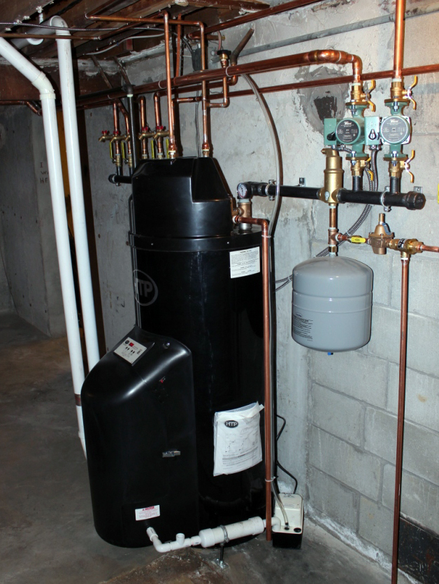

With any new boiler it's worthwhile considering adding an indirect-fired hot water tank as an other zone, since that increases the duty-cycle on the boiler (which increases it's AFUE), and when operated as the "priority zone", the water heater would have higher performance than most standalone tanks even with a tiny ~50K input/82% 2-plate cast iron boiler. The net hot water heating efficiency will be higher than any non-condensing tank water heater too.
Dana
In the trades
7,889
512
01609
If opting for a high mass gas-fired system w/ domestic hot water I'd take an HTP Versa over a System 2000. An HTP can't short-cycle on any sized zone, and has higher combustion efficiency and even lower heat-stranding than the Sys2K, and takes less space. (If oil-fired the Sys2K is about as good as it gets though.)
Versa Flame
System 2000
