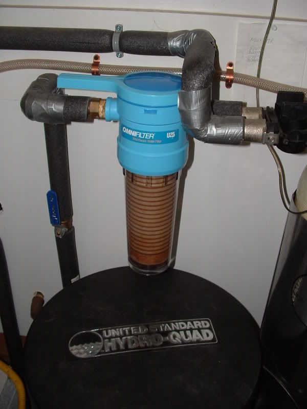

This is what I did on mine:
The blue shut off valve on the left is the main water line feed coming into the garage from under the house off the pressure regulator. I highly recommend adding a shut off valve for easier access in an emergency (mine was under the house), plus it makes changing the filter easier. Our city water tap is at the end of the main on our street, so we get a lot of crud as you can tell by the filter condition. I have since replaced the filter housing to a different model after this one basically fell apart.
The water softener is to the right of the filter and from there it feeds to the water heater out of view on the left and the cold water supply going back under the house.
I recommend connecting the 3/4" feed line off your water softener to a 3/4" cold water supply line feeding the rest of the house and not to a 1/2" line as this could affect your water pressure. I only notice a decrease in water pressure when the filter needs to be changed. And yes, the water softener does have bypass valves.
