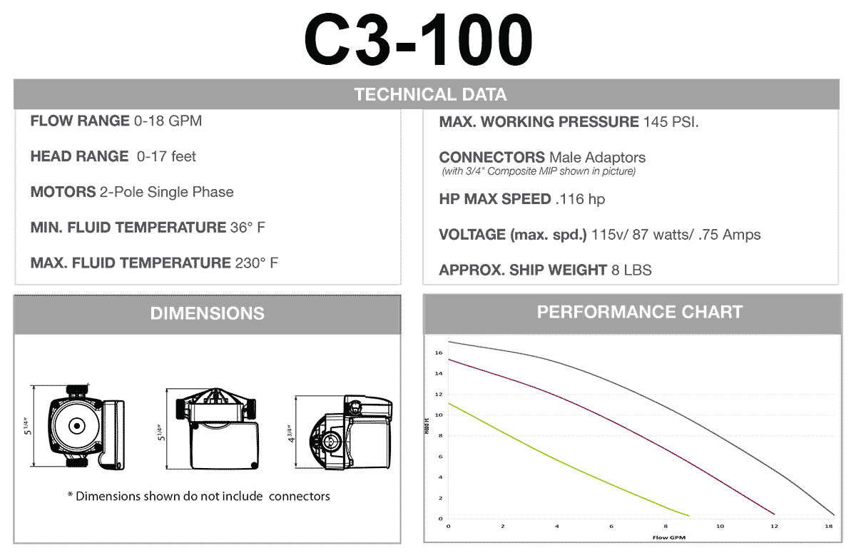

I recently came upon the D'MAND Kontrols® Systems by ACT C3-100 which uses a 0-18GPM pump using the same 3/4" connections....so am I overthinking this/worrying about nothing?

https://www.plumbingsupply.com/images/act-dmand-kontrols-system-c3-100-specs.png <---this thing is 0-18gpm and looks to be 1/6HP to be hooked up to 3/4" lines and says "For pipe runs up to 120 lineal ft." (Does that include the return line?)

I don't know what that graph you pointed to means. If it says 100 lineal feet, I would think that would mean 50 out and 50 back. But maybe you can find different literature or ask the maker.
