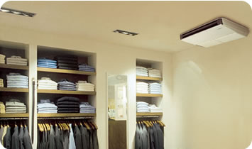

    They make flush-mount ceiling cassettes and suspended ceiling variants of the interior unit, if you can't find a suitable place on a wall where it doesn't destroy the aethetics. They're more commonly used in commercial applications though, and at the low-output end you might not be able to use them with the smallest of mini-splits:

    Now I'm going to sound like a real idiot but I didn't realize they heated as well -- but now you mention it, it is like a heat pump system in theory?
    Anyway -- thought they were just for AC -- so definitely have to get a system setup now. Those ceiling units are great! Good thing also is if I use (2) room units I can put the outside unit within 5 or 6 feet from both.
