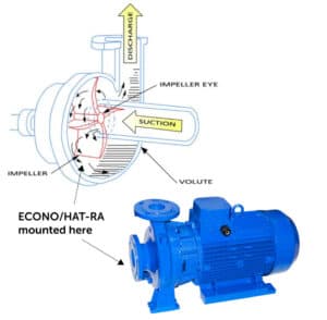

What I did was put a temperature relief valve on my pump.
When the pump dead heads and the water overheats, the valve will release water until the low pressure cutoff powers off the pump.

Hope it works for you. You are correct we no longer make a 115V version of the Cycle Sensor. But that motor should be dual voltage and able to run on 230V if you wanted. Never had much luck with heat sensors. By the time they get hot enough to pop off the pump can be damaged. If the temp set point is lowered, many times they would pop off just from the heat in the well house with our hot southern climate. I am also not sure that will pop off enough flow to get the pump to the low pressure cut off setting, but maybe.

The temperature valve trips at 40C if I remember correctly. Fortunately (or unfortunately) I never had to test it. After my pipe melted the first time, I fixed the underlying issue and I haven't had a problem since. Unlike the OP, my well wasn't running dry. Rather, I had a suction leak and the pump was losing prime.

Might work for you in cold country. 40C is 104F. I would have to air condition my well house to keep the ambient temperature from popping it off. Lol! Don't know if it would be code, but I think you could split off of the 240V at the well house and still have the 115V.
