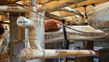

... if you aren't going to dry vent the tub, you have to went vent the tub, and the only option I see is to use the lav drains as is typical. That makes the lav drain take a circuitous route out of the area, but that's fine.
Wayne... looks like were getting closer ... its all starting to makes sense. Thanks!
Two questions. You state "the lav drain takes a circuitous route"... Sorry afraid I need to a little clarification as I'm not sure if that statement and drawing were literal or figurative. Does the circuitous route need to be constructed as shown in your drawing (now indicated by the purple dotted line in this drawing)... or... when routing do can I simply I take the shortest route as long as the lav drain joins in where you originally indicated? (blue line from lav drain to sewer pipe only shown to clarify my question)
On another front... it appears my biggest mistake was thinking I had to include the original vent stack and failing to ask the pros in this forum before I went through all the planning and work to accomplish the relocation. :mad: All my planning on this new bathroom floor plan centered around finding a place to relocate the stack that would not interfere with any obstacles, rooms, floor or ceiling joists, etc. Was proud of myself for successfully pulling off its relocation. Part of my frustration is due to my time and energy spent in thinking a vent was required in pulling off the relocation only to have it serve as a lav vent which could have been wet vented. This takes me back to an earlier question. Could I have just capped off the 3" pipe on the roof and planned this entire project without any vent stack at all? I'm confused because every house I've ever lived in (all older ones) have always had one or two vent stacks. I'll have to pay closer attention to some newer homes next time I'm out driving around.
Elton Noway
81
North Carolina
why not offset the main back a ways and come up in the "new vent location" and pick up shower and w/c from there ? and perhaps using a wye where doing that offset picking up the lavs and tub off a 2 inch branch or bushing down a 3 inch wye to continue to lavs and tub. Sorry I know Im not real clear . Id kinda like to use that 3 inch vent if its easy.
Wayne probebly brainstorming up something good LOL !
Hi Jeff... When you say "offset the main back a ways" ... need some clarification. Do you mean cutting into the 4" sewer main and reroute the portion that falls under the bathroom so would be located on the other side of the main beam? (Obviously the entire "octopus" at the clean out end is going away since its all the old / original drain system)
Primarily figurative. I wouldn't advise the particular diagonal route you drew. But you could cut off most of the corner by using two 45s.
I answered this question earlier: "Both your lavs will be need to be dry-vented, so those vent(s) will need to connect to your existing roof penetration. It's just that you don't need a 3" dry vent that goes all the way from the 3" / 4" drain below the floor up through the roof."
Cheers, Wayne

OK, below is an option that is closest to your original vertical design. [3" = orange, 2" = blue, 1-1/2" = green.] You have a 3" stack at the specified location. It dry vents the WC and the shower, because the shower is close enough and the WC has no distance limit from its vent (under the IPC). The shower needs to connect to the the stack above the WC.
But the tub and the lav are too far from the 3" stack to be vented by it. So they each get a separate 1-1/2" dry vent, represented by the green circles shown. Those dry vents have to rise to at least 6" above the fixture flood rims before going horizontal or connecting to the vent portion of the 3" stack. Connecting within the ceiling framing or attic is often a good option.
The elevation of the lav and shower drains connecting to the 3" stack is unregulated, because they are already vented, so they don't depend on the stack for venting (unlike the shower); and as non-WC bathroom fixtures, their connection to the stack wouldn't disrupt the venting the of the shower. [If the shower is topmost connection, then it is dry-vented; if the lav and/or tub drain connects above, then it is vertically wet vented; either way is fine.]
Now the drain for the 2 lavs is not serving as a wet vent for anything, so the IPC allows a 1-1/2" drain to carry 2 lavs. But if you want to use a double fixture fitting to take two lav trap arms off a single lav stack, then you'd need to use 2" for the drain carrying both lavs, as I'm not aware of a 1-1/2 x 1-1/2 x 1-1/2 x 1-1/2 double fixture fitting.
Cheers, Wayne

Great! Thanks Wayne. It all makes sense. As you might guess I have a question. As long as I maintain the correct slopes and tie in all the various drains as you indicated in your instructions... does it make a difference "where the the new vertical design stack is located? Here's the deal: The new stack location enters the crawl 30" from the main sewer line. Should I assemble the stack (i.e. octopus) directly under the new stack location then use an angled 3" pipe to exit the bottom of the stack and angle it over where I would tie it into the existing drain?... or... Since its a dry vent, could I put a 90 on the new stack after it enters the crawl just below the joists, add 30 " of pipe (slightly sloped) at an angle so it falls somewhere along the center axis of the main drain (dotted lines in photo) , then assemble the stack vertically directly over the main sewer? The reason for asking is although the new vent location works great for everything above the crawl space but where it enters the crawl gets a little crowded, about a foot from a hard HVAC plenum and a 18" flexible duct. Not that assembling the stack in the area is impossible, just less elbow room.
Or... was the idea for me to move the 4" main to the other side of the main beam and go straight at the new vent location? If I cut and move that section of the 4"" main I'll have to tie it back it to the rest of the line (assuming a couple 45's is not a problem).
Sorry for all the questions
wwhitney
6,567
1,847
Berkeley, CA
Yes, under that plan.
No. The portion of the DWV above the highest drain entry to this vertical configuration is a dry vent. And dry vents have to stay vertical until at least 6" above the fixture flood rim. So you can't offset the dry vent under the floor like that.
For that design, the 3" pipe outside the footprint of the bathroom would presumably be close to the elevation of your existing 4" building drain, since you'd be coming out the bottom of the vertical configuration with a long turn 90.
If the vicinity of the proposed 3" stack is crowded, I don't see much upside to actually having a 3" stack, so you may wish to consider the following horizontally wet vented configuration. The tub drain gets dry vented and wet vents the WC and shower. All the piping shown would be close to the underside of the joists, and not shown would be a vertical drop (via two 45s or two 90s) to connect to your 4" building drain. [Actually the building drain connection should maybe be via a wye or combo, so that you can extend the 4" drain a bit upstream to a cleanout.]
Cheers, Wayne

The main requirement in the IPC for vent sizing is that a vent must be 1/2 the diameter of the minimum required drain diameter. 904.1 does require a vent through the roof that is at least as large as 1/2 the diameter of the required building drain size (the drain size for all the fixtures in a building).
The IPC allows 42 DFU (drainage fixture units) on a 3" building drain sloped at 1/4" per foot. So a house with 42 DFUs or less is OK with a 1-1/2" vent through the roof. If the numbers of DFUs exceeds the limit of a 3" building drain, then you will need a 2" vent through the roof.
However, NC has amended those sections of the IPC. It limits a 3" building drain to 3 WCs total, via Footnote c to Table 710.1(1)
Moreover, NC has amended 904.1 to require a minimum 2" vent through the roof. And 904.1.1 says that 2" vent must connect to the building drain or a branch thereof that is at least 3" in diameter.
That last part is news to me, and so the question is whether the 4" building drain that extends off the page to the right has any other stacks connected to it that have a 2" vent through the roof?
If not, then the bathroom layout needs to be adjusted to add a minimum 2" dry vent to the 3" WC line. That's not hard to do; the layout in post #27 does that already. To decongest that area labeled "new vent stack location" that has the rigid air return ducting right next to it, the separately vented lav and tub drains could be rerouted to join the 3" branch or 4" building drain downstream.

it also has one 2" roof vent coming up from a second full bath lav
If that path from the roof down to the building drain consists of a 2" dry vent connecting to a 3" drain stack connecting to the 4" building drain, then if I understand NC's amendments correctly (not sure), that would take care of compliance with them. In which case you don't need to try to comply with a 2" or 3" vent stack in the bathroom you are working on.
Or you could play it safe and try to comply with this bathroom. I.e. pull a 2" dry vent off the 3" WC drain line, rather than wet venting it via the tub.

Makes sense... thank you! Of all your designs I plan on going with your layout from post #27.
Question: As you know this layout utilizes a partition wall between to toilet and shower which was a consideration after I "incorrectly" stated the left and top walls of the drawing were not available for consideration in your plumbing designs. Actually there is a four foot section on the far left of the top wall that could be utilized, which raises a question.
The "original" 1 1/2" lav vent ran up the lav wall and above the ceiling and up again where it eventually ties into the 3" stack in the attic. I made no change to that layout other than moving it to the right so it now falls over the new lav wall. So... rather than using a partition wall between the toilet and shower to dry vent the tub ... could I tie another 1 1/2 vent line into the existing 3" stack up in the attic and run it down into the crawl space via the four foot section indicated by the green dotted lines in the photo... and if so, where would I tie it in?

Again, dry vents have to come off a trap arm vertically and rise vertically until at least 6" above the fixture flood rim level.
So if you want to use a dry vent riser in the portion of the wall you outlined in dashed purple, you would need to reroute the tub trap arm to travel under or next to that wall. 45 degrees from plumb is still considered vertical, so if the tub trap arm is next to the wall, the dry vent could come off it and rise at a 45 to get under the wall plate and turn up into the wall. With your drains under the floor joists, the dry vent could offset around 12" laterally while rising around 12" below the subfloor. The tub drain routing would be a bit circuitous in the end.
Or just as good, since you said the lefthand (on the page) wall is also a possibility for venting, you could put a dry vent in there, between the tub and WC. For that I'd suggest shooting the trap arm coming out of the trap straight toward the plan location of your dry vent, hitting a san-tee in the usual vertical configuration for the vent takeoff, and then having the drain outlet of the san-tee immediately hit a LT90 to turn horizontal, pointed back towards the right side of the plan. (* see below for a variation)
So those are your options for venting the tub: wet vent by rerouting the lav drain, or dry vent in the shower wall, in the portion of the wall on the top of the page, or in the wall on the left side of the page.
Cheers, Wayne
(*) a variation on that is to bring the vent riser through the floor in the knee wall, and then have the vent rise to the left at a 45 to enter the lefthand wall below the top of the kneewall. [Or if the kneewall is at least 12" taller than the tub flood rim, you would have room for the vent to rise vertically to a 90 that is 6" above the tub flood rim but still within the knee wall.] This would let you point the tub trap outlet up the page, turn the trap arm to the the right with a LT90, and then take off the vent with an upright combo. That avoids the elevation drop from using a san-tee and LT90, which I suggested because you would need the trap arm to do a 180.
