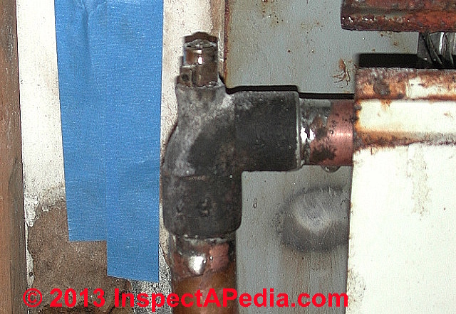

Bleeder valves look like this:
or this:
There are varations on the theme, but they're usually really small, screwdriver operated things.
It's rare to see a multi-story hydronic system that doesn't have a bleeder at least somewhere on the upper floor unless it has a system vent somewhere on the second floor.

Yea, so the aquastat bulb is either not feeling the true boiler temperature, the gauge is off or not feeling the true temperature, the boiler is filled with muck or the aquastat itself is NFG.
Dana, your 1st picture ain't a bleeder, it's just a shutoff/ balancing valve.
Very few 2nd story loops have bleeders of any kind on them. Air can be purged from the boiler return.

I could believe a screwed up aquastat OR a bad temperature gauge, but if they are in approximate agreement it's hard to say how they could both be off.
There are variations on the bleeder valve morph- I didn't recognize that pic as a balancing valve.
Tom has probably seen an order of magnitude more systems than me, but I've always found at least one place to bleed the system on the top floors of older systems like this. The cast iron blob the system vent is screwed into in your pictures doesn't look much like more recent vintage air scoops, but may provide that function.
Air purging a system with a big bubble in the upper floor loop without a bleeder or vent at or near the top of the system can be a real PITA, but people do it. If it's been running for weeks/months and heating the zone with 160F output when it's 0F outside, it's not too likely there's a lot of air in the loop.
