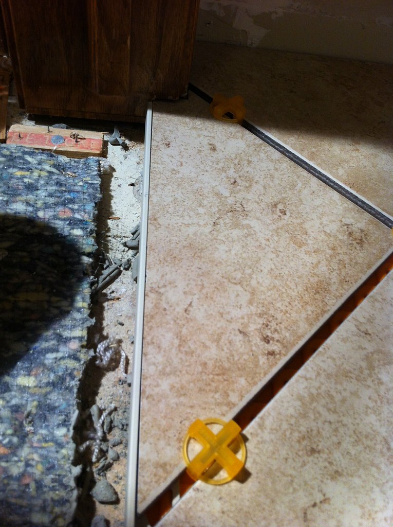

OK, I'm back at this project and ran into an issue. I borrowed a tile saw, and after fighting with it (the water system was shot, and I found out after making several cuts that the feed table was not in line with the blade) I've made a bunch of cuts while dry laying the tile.
At the doorway I decided to use a Schluter strip. I was under the impression that this would hide the very edge of the tile, covering any imperfections in the cut edge. I was incorrect. It really just butts up against the Schluter strip, and my slightly imperfect cuts are really bothering me. Check out my pic. I can probably get the cut straighter than that, but it won't be gnat's butt perfect. Also, I despite having what appears to be a good blade I can't keep from getting a few tiny chips in the finished surface of the tile right at the cut edge. The chips are maybe 1/64" in size but it's dark brown under the finished surface and butted against the Shluter strip I'm just not happy with the finish.
Ideas?

What color grout are you planning on? The trim strip is meant to have a slight gap and to be grouted. The grout will tend to hide some imperfections. It doesn't look like you have the right trim strip...they come in numerous heights to correspond to the tile thickness. It should be flush with or slightly below the height of the tile after setting with thinset. It depends somewhat on how thick of a thinset setting bed you are planning (i.e., notch size and spacing) whether it would line up properly.
A misaligned sliding tray, too much slop in the tray guides, a worn blade or bent blade, an out-of-square motor shaft, and a worn motor bearing along with the incorrect blade or not enough water can all cause problems on a tile's edge. There are probably other things as well. A tile stone might be useful to knock the edge down slightly. I happen to use a diamond pad. If all else is perfect, feeding the tile too fast can also cause this.

No, the "bad" cut is the one that is up against the trim strip. The other cuts, like the ones around the door casing, are easier to hide. I did cut the casing molding at the top of the tile to slip it underneath. As you said, it's too dark in that area to see what I did. :)
Hmm, I think the grout is a tan, darker than the tile but not terribly dark. I was no aware at there was supposed to be a slight gap filled with grout between the tile and trim strip. How much of a gap, approximately?
Am I correct that the trim strip fits directly under the tile, then the whole thing goes down on the thinset bed? You can't tell from the pic, but the trim strip is a tiny bit higher than the tile when fit in dry, maybe 1/64" higher. I was going to use a 1/4 x 3/8" trowel.
I corrected the sliding tray alignment. Not sure how much is too much, but the tray guides and saw blade dont seem to have too much slop.
If I knock the edge off the tile, it will show the dark brown tile underneath. It seems like the cut edge should definitely be beveled, but won't the dark showing through look bad?

The picture makes the trim look higher than that small value, so once thinset is under it, it should be okay. If there isn't at least a slight gap that can be filled with grout, it will act like a very good dirt, crud catcher that will be nearly impossible to keep clean. Also, it stabilizes the edge better as the trim would be essentially glued to the tile edge by the grout. As to the edge, maybe just a pass or two with the stone to take the sharp edge off, but not expose much of any of the base layer. That's one reason why I like through-body, unglazed porcelain...you can play with the edges and not see the core, since it is the same as the surface.

So am I right about installing the trim strip? The tile sits directly on it? Or is there supposed to be grout between the two?
Should I thinset in the trim strip first? Or at the same time as the tile?

You need thinset under the flange of that trim strip, it probably has perforations for the mortar to ooze through.

Yes, it does. How thick of thinset should be between the flange and the Ditra underlayment?
I know I'm probably over thinking this, but I don't want to have problems later like I've seen with other do-it-yourself tile jobs.

Spread out your thinset, smush the trim down into it as if it was a tile, add a little more on the top of the flange, then set the tile. You want a little gap so it can be filled when you grout the tile. If in doubt, call Schluter.
