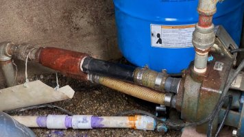

I have an odd one. I have a well to my old lake cottage. 2-inch casing, new pump 3/4hp, new pipping, brass fittings, new check valve. I can get the pump to prime, and it will work maybe for one or two fillings of the new bladder tank. Then boom, no water.
Just to the hour prior to changing the pump, I had well water, decent pressure, we had 3 people shower, dishwasher run and a load of laundry, along with washing out the paddle boat with the hose ran 50 feet down to the shoreline. I turned the well power off and he proceeded to change the pump.
The original problem was the well pump would get stuck and not start. It started to increase in frequency. so, I decided to have the pump replaced. In that process the well company that replaced it could not get it to prime after replacement. (Keep in mind no priming issues prior) only a pump that would just hum and not spin. (If tapped it or power cycled it would start back up, no priming needed and go for a bit more, maybe a weekend.) I was initially going to do this myself, but the setup looked different, so I had a company do it.
After he left that I noticed when priming the pump, myself as he left unable to get it to prime, that water was coming back up the well casing when I was priming it.
So, I called him back out and we replaced the foot valve, in hopes that would solve the priming issue as well. It solved the problem of water coming back up the well casing and out the top, but not the issue of losing prime.
Now they are telling me I need an 8k for a new well to be dug and plumbed in.
I have included pictures of the before and after, I am having hard time swallowing in the 3hour install process that my well went dry. They did install a 3/4hp pump, I had 1/2 hp pump.
Any help would be greatly appreciated, a new well is not in the budget this year, and it just feels odd life was happy prior.

If you are losing prime every time you say "boom, no water" then I think you have a suction leak. I would have used two hose clamps per connection with buckles 180 degrees apart. You can get a suction leak from the wrinkle under the buckle or screw. The pipe to the well was changed, somewhere you have a suction leak.
I could definately get more hose clamps. There is only one clamp at the foot valve as well, it does hold prime for 3 or 4 days if the pump is not used. Meaning my pressure gauge seems to only maybe move a pound less when I come back the following weekend.
I am only at the cottage on the weekends for the most part. So when I arrive this weekend, it probably still be sitting at 48 - 50 on the pressure gauge. The issue appears before the pump is running. I hear the pressure tank make a wishing sound like the last bit emptied and then the pump kicks in and try’s to recover. If this makes sense. But often doesn’t.

Yeah the screw. May not even need to heat it. Just put on the extra clamps with the "Screws" 180 degrees apart. The one on the foot valve doesn't need it as that one is under water.
There is likely a small suction leak that is putting air above the water in the tank. That "wishing" sound is probably the air pushing the water prime out of the pump. Water molecules move slower through the leak than air molecules.

I only need to truly" find the leak if there is one from the injector (front of pump) to the foot valve correct? A small water leak coming out of the top of the pump or past the bladder tank would not cause it I am guessing, as I know I have had leaky pipes in the house before I found them.
The possible issue if I am understanding everyone, is a possible leak between the foot valve and the front of the pump. Foot valve is new along with its attachment to the suction line, only one hose clamp on it, but not as important since it is submerged in water, focus more on the topside I am guessing? The visible line of the suction. Yeah it sounds like the bladder tank empties totally with a mix and and water and then its done, it never recovers. Seems like the pump should cut in just before the tank gets that low, but maybe not.

Put a gauge on the suction side of pump with tee fitting and valve to check water pressure when pump is off and can inject air to raise pressure if needed to see if there's leaks between foot valve discharge of the pump.

3/4 verses 1/2HP shouldn't make any difference. Yes the leak is only on the suction pipe somewhere. You can use foamy shaving cream on the connections, where you can see a hole sucked in the foam where the leak is.
