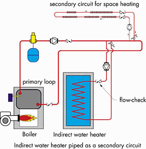

Lochinvar recommends always plumbing it as primary/secondary, with a hydraulic separation external to the boiler (see page 38 of the manual.) I don't believe there are by pass branches such as hydraulic separators etc. The stated reasons for that recommendation are:
It is recommended that near boiler piping systems utilize Primary/Secondary configurations as shown in FIG.’s 6-3 through 6-9 only. The use of other near boiler piping configurations could result in improper building and system flow rates leading to inadvertent boiler high limit shutdowns and poor system performance if proper pump sizing and system flow rates are not adhered to.

The unit is not set up as primary/secondary. The 1" copper exits the boiler output and branches to each zone at 3/4". It is only a 1300 sq ft single story ranch and the boiler is located centrally in the basement. I only mention this because several years ago when researching how long each loop could be, I recall being well under the length to be concerned about flow restriction.
A few months ago I did turn the pump speed from high to medium to see how this impacted the performance. The delta T increased maybe 12 deg, which I believed would cause the unit to run more efficiently. It was not until a while later than I changed the setpoints.
I can change the pump speed back to see if there is a difference, but thought it would not be beneficial because of 1) the lower delta T (efficiency) and 2) a higher inlet temp which would again push me toward the high limit lockout.

A closed valve is a closed valve, and the pump won't pump through it.
If this system is set up with only a single pump and some zone valves, pumping-direct through the boiler rather than primary/secondary, there is NO post-purge occurring at the end of a call for heat, but there would be if the boiler reaches the high-limit while the call for heat was still ongoing.
That is one of several reasons why a local pumping loop (called the "primary") setting the flow through the boiler, and another loop & pump driving the zone flows, with a hydraulic separator of some type where the loops intersect can be a good idea. When the radiation flow requirements are a reasonable match to the boiler's flow requirements pumping direct (no primary/secondary) is often possible, but has to be designed to work OK at all temperatures and flows. Delta-Ts across the boiler of 50F or higher can damage many boilers, and flows lower than the specified minimums for the boiler can lead to flash-boil on the heat exchanger, lowering efficiency and sometimes lifespan.
The hydraulic separator doesn't need to be a pre-engineered component- closely spaced tees will do, but the tees have to be less than 4 pipe diameters apart to minimize interactions between primary and secondary flows.
This is a simplified diagram of primary/secondary plumbing. The indirect water heater has it's own pump, since it's flow requirements are generally higher than radiation typically needs. If the radiation was broken down into zones with zone valves, the zone valves would be down stream of the radiation pump, and would not affect the flow of the primary loop driving water through the boiler.

hmm. I am glad I asked. I actually had a Lochinvar tech at my house to inspect the boiler just after it was installed and he stated that the post purge pumping would be able to pump through the valves being closed, that it was not an issue.
My indirect tank does have its own pump on its own primary loop with no zone valve
This is now a little overwhelming. I have used the boiler for almost 6 years so it is hard to justify reinstalling it...
What if I replaced the zone valves with pumps? Then they would continue to pump post-purge and I would still be able to utilize zones.
I think I will manually lock the valves open for now and increase the setpoint to see if the lockout continues. I would think that if the pump was going to fail from this, it would have already. There are only two zones and their room temps are usually the same. The issue would get worse if I wanted to run a loop in the basement.
