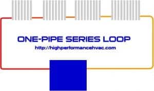

The cheapest way for me to do if I did this will be to do a single pipe series loop for the radiators:
While this presents the problem with the diminishing temperature towards the end of the loop, it may be a benefit to the boiler operation since the return will be colder and thus closer to the boiler condensing temperature. ( it also presents me with the opportunity to place my least favorite child in the coldest bedroom). Is this correct?
Also - where is the sweet spot for the supply side temperature for radiators (of the Buderus Solidoflux ilk) - 120F? 130F? 150F?

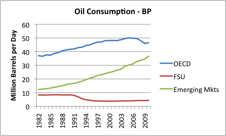

The short course on why oil heating has no future can be summed up in two pictures:
The world supply of oil is fairly inelastic to the price at the current levels. Anybody who can make a buck at $100/bbl oil is already drilling as fast as they can, and opening up drilling on public lands in the US won't much change the world supply (and thus price), only which hole in the ground it's coming out of.
...and...
Oil use in emerging markets (primarily India and China) will soon overtake that of the former Soviet Union (FSU) and the OECD (== most of the industrialized world) countries combined.
Oil production simply can't be expanded at nearly the rate of the worldwide increase in demand, and it's highly unlikely that the OECD countries (particularly USA), would be able reduce consumption at a rate fast enough to keep a lid on oil prices going forward for more than another 5 years, even if we got SERIOUS about it. In less than a decade the emerging market countries will be essentially holding all of the oil cards, not just half the deck like they are today (or the pair of queens and a one-jack they held back in 1980.) If those countries still want the amount of oil most analysts THINK they will in 2025, anybody with an oil-fired boiler is going to be paying the piper more they have been over the past 5 years.

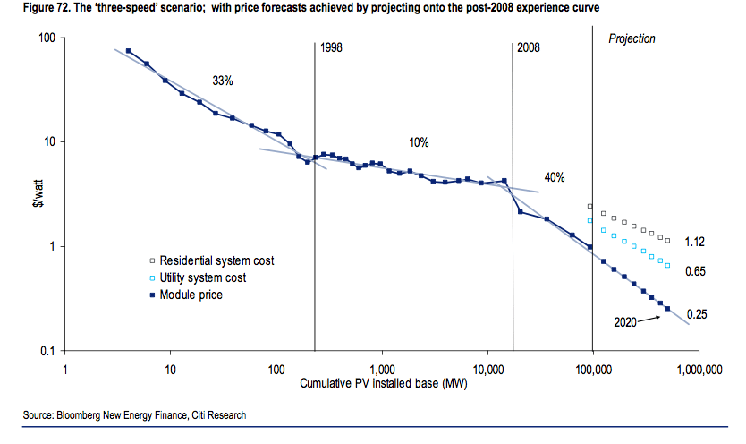

What is different about PV solar compared to most other forms of power generation is that there is very little economy of scale- a large centralized PV array can't be built by a utility for a heluva lot less than the same amount of generation installed on-site by 100,000 homeowners or businesses. As long as some amount of net-metering is allowed without egregious fees for staying hooked up for the grid it's a cheaper/better way of providing generating capacity, since it solves grid-congestion and loading issues for the grid operator, and is cheaper power for the PV owner. Building a nuke or high-efficiency gas fired generator sized for a single-home's load is way beyond affordable, but with PV it's already affordable without subsidy in high-electricity price locations like Hawaii & Puerto Rico, and will be soon enough in the cheap-hydro locations like the Pacific Northwest. It's cheap enough now in Texas and Arizona too- in part due to the higher insolation, but also due to the competitiveness of the local markets driving the prices under three bucks (allegedly in the two-buck range in parts of Texas.)
It's not quite there across New England, but in VT & MA (where it's subsidized) it's quite popular and booming. In VT the biggest utility did the math and decided that net metering was CHEAPER for them than upgrading the grid to accommodate more capacity- they will reevaluate when PV exceeds 15% of all kwh going onto their local utility grid, (eventually there will be point there might be some hardware cost to the grid operator to regulate that non-dispatchable variable power) but it won't be possible to push the genie back in the bottle and cork it. The 15% number is really the very low "no brainer" end of what the grid will tolerate without adding smarts, and even a small amount of storage on the PV owners side of the meter could make the output & load to the grid automatically more predictable. The Iowa experience with wind power says 25-30% and beyond is still probably going to be OK. PV is easier to deal with than wind power which can max out overnight when the grid loads are low, unlike PV which puts out during the traditional daylight demand (and peak demand) hours. It would be hard to imagine PV exceeding the mid-day load in any New England state, unlike CA where the utilities,regulators & grid operators are planning for it, with recently mandated grid storage targets. We'll probably be able to just burn that bridge when we come to it, but it isn't in the near future for us.
We'll see what's available on the scalable storage end when solar in VT & MA hits 15-20% grid share. It won't be next week or even next year, but it might happen before 2025, but by then there may be a winner amongst the gaggle of cheap storage techology start-ups currently vying for market share in CA and HI against the lithium ion and flow-battery crowd. (I'd put some money on AMBRI having a good shot at a slice- they'll probably get bought up by a big storage company like ABB or a big technology company like Wanxiang, who has bought and sold lithium ion battery companies in recent years.)
