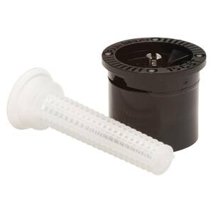

If you are on city water the anti siphon valve could be worn out that may be causing low water flow or pressure. They do come apart so the diaphragm can be replaced but it is sometimes more trouble than just replacing the entire valve. Another cause is there is a filter screen inside the sprinklers and they do get clogged up. For spray heads they are under the very top spray head.
